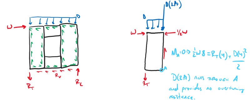

My thought process goes another way. It's not that I view the segmented wall as rigid monolithic, it's that the load path is sufficiently diffused through the wall that the distributed dead load can have a meaningful impact on overturning throughout the length of the wall. Take the crude sketch below as an example. If we have a super simple segmented shear wall L=12' H=8', you can build it with three sheets of WSP. If we look at the middle panel, it has to be in equilibrium. That occurs from shear transfer between the panels to resolve the overturning couple, and shear at the base. If there's dead load on top, the dead load directly over this panel contributes to the overturning resistance of the panel. The result is less uplift being passed to the next, and less being passed to the hold down. Of course the sum of these results is equal to assuming the whole thing acts monolithically. So any disagreement I might have with you here is academic, not practical.
For perforated I think I agree with you - the dead load over headers should not be counted in full. From the sketch below, you'll see that the benefit of half of the dead load over the opening is lost. The opposite pier, however, would benefit from half of the dead load above the header as the dead load reaction from the header and the tension reaction vectors are coincident. So the summation of those vectors will be a net reduction in tension at the edge of that panel.
For an FTAO wall, though, I think I'd still count all of it. I haven't gone too far down this rabbit hole, but I rely on the Diekmann method and I understand it to require fixity of the segment above the opening to the piers next to it. If we're relying on enough rigidity to transfer moments for the lateral load through that joint, it seems reasonable to assume the dead load reaction will be resisted by the same mechanism.
