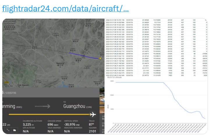

Flightradar24 for the plane (from above).
Flightradar24 uses transponder data (mostly not radar, despite the name). The transponder speed seems to stay almost the same throughout the descent, which might indicate a problem with the speed sensing if it's not just an artifact of the reporting.
Can't be sure. (It's a Boeing.)
Approximately 200mph vertical. Terminal velocity.

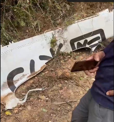

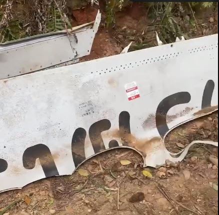

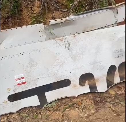

Those are from the wing, no?
A black swan to a turkey is a white swan to the butcher ... and to Boeing.
Yes, look at the second photo in Red's post. You can clearly see black characters on the bottom of the wing.

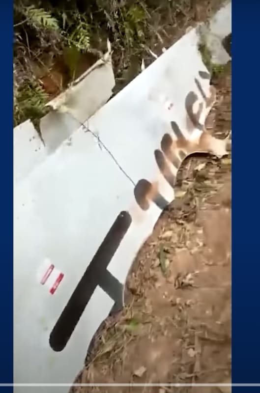

What part of the plane is this bit?
Full video here.

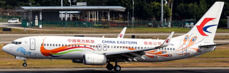

It doesn't look the same writing as all the photos as the Chinese characters are in red on all the photos I can find, but is clearly a long way from the impact location. Those dash cam / CCTV is horrendous. If the FDR survives that in any shape able to provide data it will be outstanding. But I guess the german wings crash survived something similar.
I was too late! - Good spot John = so it looks like the wings fell off....
ADS-B that you get off the web aviation tracking sites is GPS ground speed. And the data rate is spot values ever 3 seconds.
Its great and more than sufficient for controlled flight tracking and air traffic control. This crash investigation usage it is not very good.
Only thing I can comment is that it looks as if it was in one piece.
And for your information the max speed of the 737-800 at 10 000ft is 350 knots (650 km/h). Now you have to watch what the out put is of the flight radar stuff what units its in and its lateral ground speed so you would have to work out the angle with the rate of decent to get an approximate airspeed. Those numbers 550 looked hellish to me, how did the wings stay on, until I realised they were km/hr.

Yeah. That's how I figured it's a wing.
