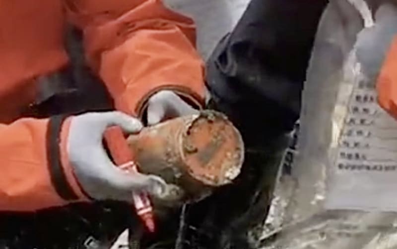

Even if the black boxes have been totally destroyed they can usually pull the solid state data out of them. They are not tape drives any more. But even so its going to be impressive if they have survived that.

That's the data module that I was on about. Apparently they are rated at 1000 g and as it was a spear in with the rest of the plane acting as a crumple zone it should be well within limits for good data recovery.
The Twitter account raises an interesting issue; can the data be stored on the cloud? even for a backup, for flight data as well as voice? Other than countries, or aircraft manufacturers objecting to not having control over the data.
there is some data squirted back to maint mostly engine data but not the full flight profile data. its normal on a out of envelope trigger.
There has been talk about having real time flight data system but the FDR records I think 3300 variables at 0.2 second intervals the data capacity required through the sat data system would be monumental.
Actually it's monumental to store on board. Is it really recorded 5 times/s?
