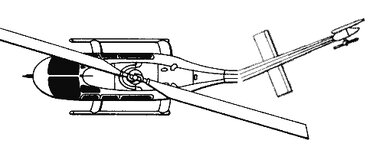

This video looks like it was flying at some speed, then something happens, it seems to change orientation very rapidly which causes the whole tail structure to detach, followed shortly by the main rotor blade and part of the gearbox. Horrible way to go.
I don't think a boom strike would cause the mounting deck for the transmission to separate from the air frame.
It appears to be a clean torsional failure.
I don't see any torsional component to the tail failure. It looks like a clean break to the right and slightly down, given the break line along the row of rivets. I don't know if a driveline seizure could whip the aircraft around so fast that the tail couldn't follow but that's what it seems like to me.

The helicopter goes sideways at over 100 knots for reasons they might never work out in less than one second so not a lot of surprise the tail snapped.
I think the tail will show signs of being hit by the rotor. The rotor was probably already damaged, maybe from mast bumping or something else that broke, and wasn’t properly held in place. It likely hit the tail, which then broke off. With the helicopter further imbalanced by the loss of the tail, the already weakened rotor eventually came off too.

Looks like something very dramatic happened which caused the helicopter to yaw and spin violently to the right which caused the break up of the tail.
The money seeks to be on main gearbox failure and hence may have weakened the gearbox which then broke off along with the main rotors.
So possibly if the main gearbox jammed and the motor flung the helicopter round before it probably broke something. Once the tail went there was no getting it back.

The yaw isn't so much a loss of tail rotor function, it's that when the drive train seizes, the inertia of the lifting blades instantly spins the aircraft in the opposite direction with sufficient force that the tail rotor can't counter even if it were still functional.

Found this picture this morning. I know nothing about helicopters, but I did hear a lot about 'mast bumping' when it first happened. Does this picture suggest that both rotors are broken at about the same length by contacting the tail boom?
The position of the rotor damage relative to the distance to the tail damage will settle this for me.
