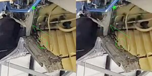

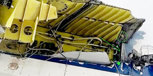

I believe the wing spar slots into the space between the heavy landing gear bracket and a lighter reinforcing piece, indicated by the arrow. The upper 3D image is taken from the TSB video and rotated 180 degrees so we're looking at the lower wing skin remnant (mirrored). We can also see the spar flange torn along the fastener holes and a stub of reinforcement (circled). The wing rib, at least this one, is attached to the skin with a series of tabs, which tore off the rib.
Of interest is the depth of slot as determined by the outline on the recovered spar. Also, the spar tore straight out of the slot with barely any damage to the lighter reinforcement plate. This indicates the spar web failed in tension as the structure pivoted about the fuselage interface (star) while the flange sheared along the fasteners.

On another note, I estimate the spar is deformed over 12", maybe even 14". I used the open spoiler as a reference, being about 45", scaled from a reference drawing in the CRJ-900 Airport Planning Manual, here. In the following image, the line of the spar is indicated in blue (it's easy to cross-reference the wing coloration with other images). The deflection extends as far back as the MLG rib. There can't be any doubt left, the landing gear was not the cause of the calamity.

Excellent work sir.
I am not surprised on your findings though.
You just need to get near one in real life to understand they are not the weakest link.
Quite often they are the only thing left after an accident.
The slot is a section of cruciform plate.
TSB's images do state the exact sequence of events has not been determined yet, so I don't think they're off on the wrong foot missing the obvious reasons.
I have no idea what I'm looking at anymore, but the conclusion seems good to me, i.e. the impact with the ground on one wheel basically exceeded the wings capacity and it found the weak spot. Once that went it all cascaded from there.
Basically. Only thing not known yet is would the wing have failed in an undamaged state, or was there previous damage or manufacturing/repair issues that lead to the hard landing being even worse. The gear bottoming out hard yet still being functional and at the correct nitrogen charge is a bit surprising to me.

My apologies for the mental gymnastics with the flipped and mirrored images, they are a challenge.
I've worked with aluminum plate and wouldn't call it weak. Certainly orders of magnitude greater than milk toast. Aside from the oleo, it is only fortunate the structure had avenues to absorb so much energy and all survived.
Regarding the failure mode of the spar web, it's the sum of all stressors, not purely tension or shear (though ultimately, it is diagonal tension that breaks it). Tension seems to have played a significant role.
