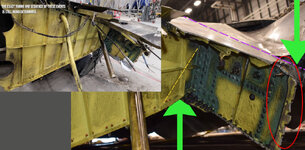

I too don't see how they determined side-stay fractured upon landing impact, rather than fractured after the 'rear'wing spar failed, and as front wing spar and wing separated from fuselage.
Corrected above.
The side-stay would fracture in close succession to the rear spar failure. The front spar would go later.
Regarding the spar shear image, I see a strong argument for fatigue failure.
The side-stay connection looks to be rather elongated, another clue! 🔎

Right side-stay oriented as deployed, seen from the rear (note the hose fittings run along the aft surface). The schematics are of the left side, shown from the front. It has been removed from the fuselage, where it had remained attached. FWIW the video image is manufactured by cutting out the side-stay and pasting it over a background image.
Given the fracture and elongation of the connection hub, the MLG was pulled away from the centerline of the aircraft and aft which is not consistent with the MLG collapsing to its retracted position. Unfortunately, social media is running with the report indicating the gear collapse as the leading theory, caveats notwithstanding.

I believe the image of the rear wing spar shows that it is substantially bent down from the wing surface, consistent with the fuselage punching down through the wing box with the landing gear firmly planted under the wing. The adjacent rib is creased accordingly (yellow dashed line). The wing trailing edge does not deflect downward since it is only substantially attached to the wing structure outboard of the MLG. I'd like to see the damage to the wing spar hidden by the rib.
