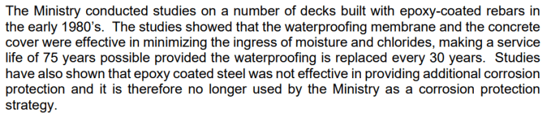

1A) At least one early application (MTO project in Ontario) had full coating failures leading to complete debonding. The manufacturing issue was fixed and has not been a problem since but people still remember. Actually, the MTO does not use epoxy any longer and now specifies SS rebar in splash zones (see pg 15 of the bridge manual).

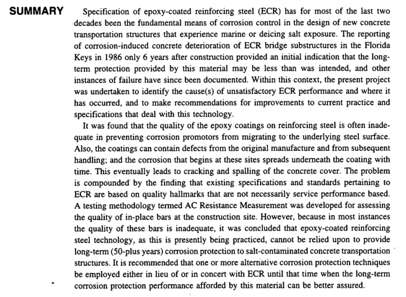

1B) Also, less vivid failures have been noted elsewhere (though again, from early products -1986 Florida Keys for example). This research note by the National Cooperative Highway Research Program is pretty good reading (summary below).

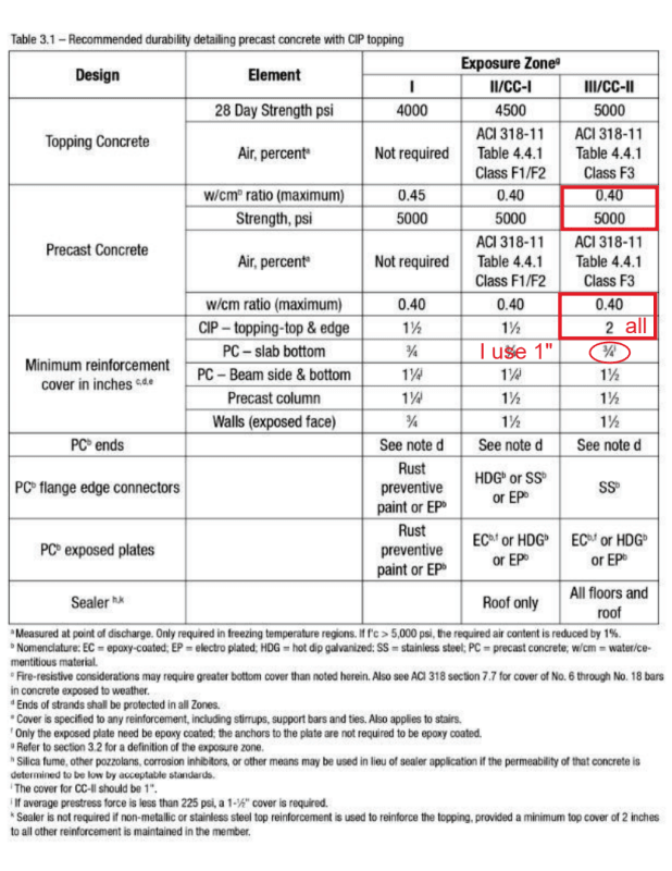

Some issues... I've been involved in the design of many parkades. One of the first companies I worked with specialised in them. Exposure has been in the structural design of them as well as the general planning and layout of them.
[ul]
[li]high quality concrete: strength, w:c, crack control and expansion joint locations, and slump[/li]
[li]adequate concrete cover to reinforcing[/li]
[li]selection of proper structure and proper structural design[/li]
[li]good design of parkade: good slopes and drainage, proper maintenance and possible wearable membrane.[/li]
[/ul]
From another thread, I'm marked up the notable items.
