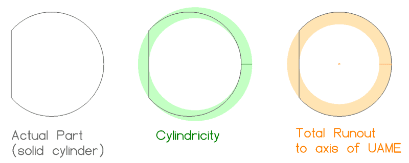

I'm trying to understand why cylindricity could be considered "equal" to "self- referencing" total runout, but not the same thing could be said about circularity and circular runout.
Your initial question involved both cylindricity/total runout and circularity/circular runout, initially stating that cylindricity and so called "self-referencing" total runout were considered equal and supported it with a quote from pmarc, which you repasted. I would disagree with that quote from pmarc, I believe we established from other discussions that they are indeed actually not equal.
In regards to circularity/circular runout I think the below figure from Evan's post on (24 May 18 22:18) in the thread would apply as well since the axis about which circular runout is measured is still the UAME of the datum feature (in this case, this is of course the same as the UAME of the feature of interest). For cylindricity/total runout it would just apply over the entire feature surface, but for circularity/circular runout it would apply at each cross section.
All credit goes to Evan (axym) for this figure.
Thank you also for the note about incorrectly labeling the 2018 standard as 2019. Clearly as you can see from my many corrections that my brain was not quite working 100% yesterday, I should proof my work more.
Although I truly appreciate the trust that is put in me, I am kind of surprised that my statements from the other thread have been used in this discussion. I thought I clearly admitted then that I was not correct and that Evan's sketches fully convinced me.
In regards to circularity vs. circular runout thing, good example to show the difference could be for example the shape shown in fig. 5-4 in Y14.5-2009. If we imagine that in each cross-section perpendicular to the axis of the dia. 16.4 outer boundary the pin is perfectly circular, the measured circularity error will be zero, while the measured circular runout error (relative to the axis of the dia. 16.4 boundary) will definitely not be zero.
Actually not to nitpick but sections wouldn't be taken perpendicular to the axis of the 16.4 dia outer boundary, but per the definition* the cross sections would be taken perpendicular to each point along the spine defined by the feature, right? So they could indeed be perfectly circular as you say.
Thank you for pointing out that figure - I agree this is another good example of the differences between circularity and circular runout, which can be even more pronounced than cylindricity and total runout. Although cylindricity does not require an axis be defined, the concentric cylinders which bound the tolerance zone naturally form one which in many cases might coincide with, or at least be very close to, that of the UAME axis utilized for total runout measurement. On the other hand, circularity has no such natural formation of an ideal axis and each section is instead taken perpendicular to the spine defined by the feature, while circular runout still utilizes sections taken perpendicular to the UAME axis. One can imagine from looking at 5-4 that these deviations can be quite extreme with high circular runout while showing zero circularity error.
*actually the definition mentions both axis and spine, but I am operating under the assumption that one does not get to choose - if the feature is curved the ideal axis is instead a spine.

There is one reason (apart from the fact that the latest version of Y14.5 in fig. 8-10 specifically states that the cross-sections should be perpendicular to the axis of the UAME) why I decided to mention cross-sections perpendicular to the axis and not to the spine, and it is basically certain consequence of allowing the cross-sections to be perpendicular to a spine for nominally cylindrical features. The consequence is that the commonly known, widely accepted and explicitly given rule that the circularity tolerance value must be less than the size tolerance value (when Rule #1 applies) is not true any more in geometrical sense.
So if we take, for example, the upper right picture in fig. 5-7 in Y14.5-2018 (fig. 2-6 in Y14.5-2009), where all local sizes of the dia. 20.0-20.1 pin are at LMC and the pin is a banana within 0.1, and assume that the cross-sections for circularity error measurements are taken in planes that are perpendicular to the spine of the pin, I don't see why a circularity tolerance, if used, would have to be less than 0.1.
greenimi,
pmarc said:
Evan, thank you for the sketches showing the subtle difference between cylindricity and what CH shown in his figure B.
This is where I admitted there is a difference between cylindricity and the scenario with so called "self-reference" total runout.

Yes, if we agree that for nominally cylindrical features the cross-sections are perpendicular to the spine.
No, if we agree that the cross-sections are perpendicular to the axis of UAME.
I guess circularity issue has been discussed recently (after the release of 2018 standard) and here is a quote from Evan :(
Evan said:
Interesting observation about the circularity description and the new reference to planes perpendicular to the axis of the UAME. It's hard to say what they were thinking with that, because there are conflicting indications:
-As 3DDave pointed out, this would exclude cones because they don't have a defined UAME (despite this, Fig. 8-10 includes an example with a cone)
-The circularity section in the text (8.4.3) does not mention the axis of the UAME. It refers to planes described in 3.6 (a) and 3.6 (b)
-3.6 (a) describes planes perpendicular to the axis or spine (curved line)
I would have to say that the cutting planes do not have to be perpendicular to the axis of the UAME, despite what it says in the Fig. 8-10 caption.
Between this and greenimi's mention of actual local size, conceptually I see what you're talking about. Basically if sections are taken perpendicular to the UAME axis this separates circularity from the definition of actual local size, which is what dictates the requirement for circularity to be less than the size tolerance, right? Regardless, as above I am not convinced that the sections should be taken perpendicular to the UAME axis - and besides as you are clearly aware the requirement for the circularity tolerance to be less than the size tolerance is still explicitly stated in the body of the standard, regardless of what might be feasible geometrically. You said *you wanted to mention it for this reason, did you simply want to highlight this disparity between what would be possible geometrically vs. what is stated in the standard if the verbiage in 8-10 were not considered an oversight?
*Edit: removed repetition
After giving it some more thought I don't have strong enough arguments in support of the thesis that in Y14.5 the cross-sections shall be perpendicular to the axis of cylindrical feature's UAME.
