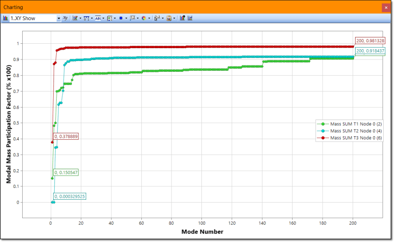

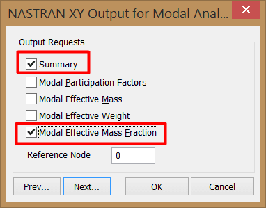

This is done pretty well in NASTRAN & FEMAP where you can compute & plot the effective modal mass fraction.
The plot of MODAL MASS vs. mode number will tell how many modes you need to extract when performing a modal dynamic frequency response (SOL111) to account for a good accuracy on the response, minimum 85%: in the following picture of a FEMAP project I had to compute a minimum of 200 modes to account for the 90% of modal mass in the three directions of excitation:
