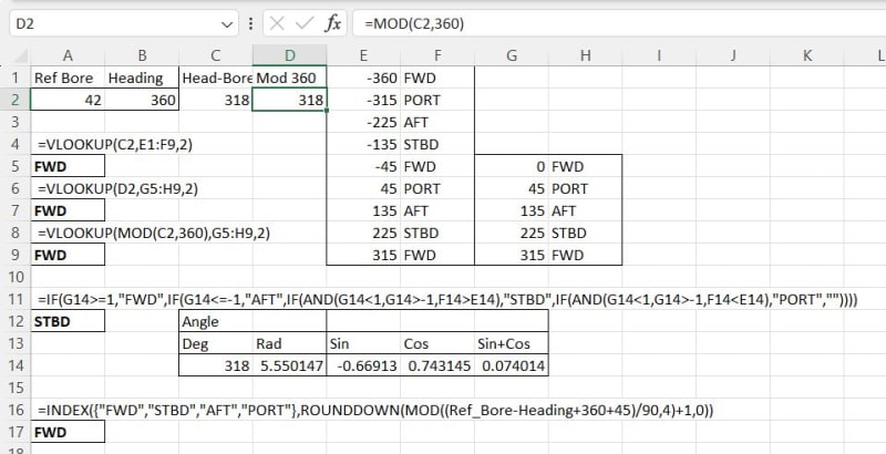

Hello,
I came across a previous thread on here which had a very helpful formula to calculate the difference between 2 headings using the MOD function
I work on a vessel and we always have a reference heading of a piece of equipment on the seabead called the 'datum bore heading'.
Now throughout this job we effectively work in a square and the datum bore will always be. FWD, STBD, AFT or PORT in relation to vessel heading
Im trying to wirte a formula where I imput vessel heading and datum bore heading and it tells me FWD, STBD, AFT or PORT
Now FWD and AFT are I can manage. If the difference between two headings is 45 or less then its FWD. if its greater than 135 its AFT
Between 45 or 135 is PORT or STBD depending on which way vessel turns. If vessel turns clockwise on compass then bore heading on PORT and and if anticlockwise its STBD
Anyone know how to write such a thing on excel?

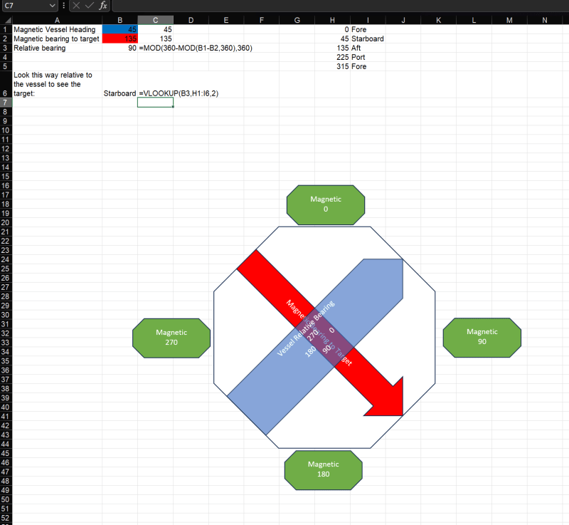

Yes, there is a 2 degree difference. But the side of the vessel is lost.
For relative barring, 0 is the vessel bow, with relative bearing increasing clockwise.
So, with a vessel heading of 1 true (or magnetic)
Bearing to target 356 true (magnetic)
Then the target is 358 degrees CW from the bow. Yes, that's the same as 2 degrees CCW, but we've lost the sign convention with the single mod, while the double mod seems to preserve the sign convention.
But the sign convention isn't lost with the single MOD, (and it is with the double MOD).
The angle we are calculating is positive for a clockwise rotation from the reference bearing to the heading, and the clockwise rotation is 2 degrees.
Anti-clockwise the rotation = -358 degrees.
Clockwise from -1 to +1 = 2
Anticlockwise from 359 to 1 = -358

How do you know if the answer from the single MOD version should be interpreted as clockwise or anticlockwise without doing something else?
It's always positive so it is always clockwise. Just lookup the value in the table as shown in a previous post:
You can either use the 9 row table with the unmodified Heading-Bearing result (which will be between -360 and 360) or the 4 row table after applying the Mod function, where the result will be between 0 and 360.
Edit: See my first post on 15th June for revised version of formula using Sin+Cos, which gives consistent results.

Doug - please either include my observation my calc is off by 45 degrees or take it off the spreadsheet.
Port and starboard will depend on what's relative to what, whether the goal is the ship's heading relative to the reference heading, or the reference heading relative to the ship's heading. Based on the terminology, the first one makes more sense.

It does seem the definition of port and starboard is causing some confusion, and the OP certainly isn't clear, but from the examples given it seems that the directions are based on the angle from the ship's direction of travel to the reference bore. If that isn't correct the Port and Stbd can be swapped in the tables or formulas. The problem with using the Abs function is that the result can change from Port to Stbd, or vice versa when the reference angle changes from 1 degree to 359 degrees, for instance.
3DDave - yes, your Sin+Cos formula will work if you use (Heading-Bore)+45, as shown below:

OK, so the double Mod doesn't have the same problem as using Abs, but it gives the same results as a single Mod, with the Port and Stbd swapped in the table.
Doug Jenkins
Interactive Design Services
By the way, I don't see the need for the extra Mod, but I'm quite impressed with your short VBA code for drawing the compass.
Very neat :)
Doug Jenkins
Thanks for your continued insistence Doug. The double MOD had been bothering me, because intuitively I didn't see the need for it either, and you and I typically converge on similar solutions.
I see now that changing cell B3 in my spreadsheet to =MOD(B2-B1,360) produces the same result.
That is MOD(Bearing_To_Target - Vessel_Heading, 360)
Somehow I either overlooked that (should have been) obvious solution, or had some other error that masked it as being correct.
