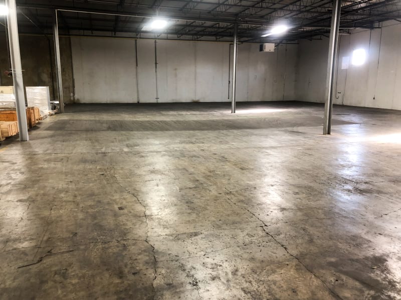

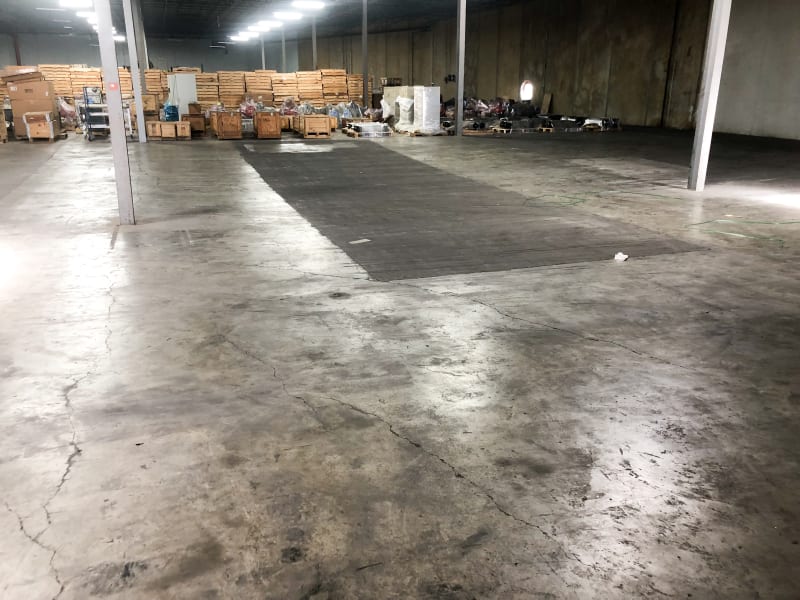

A client has a 1980's era 2 story warehouse building. The second floor is concrete over 1 1/2" metal decking, 5" total thickness. The floor deckcing is upported by W16x26 beams spaced at 7'-6" oc, spanning 33 feet between W24x55 girders. Girders sit atop W8 columns.
The floor was recently overloaded. The load has since been removed. The W16 floor beams have sagged permanently (approximately 2"-3" at mid-span). The W24 girder webs have buckled where they sit over top of first floor columns. (See photos attached).
Using a 67 psf dead load for the concrete floor, the W16's have very little capacity left. Even at 30 psf live load, the W16's are still failing due to total deflection exceeding l/240. And bending stress is 97% of maximum.
That doesn't make sense, so now I'm wondering if the floor was designed compositely. The decking looks like a composite deck, but I can't be sure. And 7'-6" is a long construction span for the metal decking, especially if it is a simple span.
How can I determine if the floor beams are designed compositely without going through a lot of destructive testing? There are no drawings of the existing building.

Good point. The beam extends past the column only 12", so the negative moment generated is fairly small, even from the end reaction of the girder connected to it. The W16 beams extend 2/3 the depth of the W24, so they are providing some lateral stability below the CG of the girder, in the negative moment region.
That said, here is a picture showing that the bottom flange moved laterally almost the full width of the flange, just as you mentioned.
I've never seen web crippling to this extent before in person... only in books and some very small deformations usually caused by some local impact force or fire.
Now... how to go about fixing it!?

Its seems from the second photo that the column moved over and the incoming secondary beam is now sitting on the column (supporting the whole floor). I hate to think that if that secondary beam wasn't there what would have happened, my guess is you would be looking at localised collapse and a lot more serious consequences.
Let the person who was in the forklift know they are pretty lucky that it didn't go further!

IMHO, scrap everything and start over.

I have never seen a any warehouse designed for less than 100 psf. 100 psf is nothing. For that reason, if calculations show the beam acting non-composite will not work for stress at least 100 psf ( I would ignore deflection) then I would have to assume the floor was originally designed composite. I would then look at current loads in the undamaged areas and see how they stack up to my non-composite calcs. If they exceed my non-composite calcs by a significant number and have no signs of distress, I am now more comfortable about the "possible composite" condition. You have a problem in the damaged area regardless, but you also need to advise the Client on other non-damaged areas. I am amazed the Client apparently has no idea what his current floor rating is. Many of my Clients are having to rate and post their elevated floors now.
They Client needs to try their best to determine what the loading was they put on the boo-boo floor. I would hard press then to recall what they stacked there. The client they were storing for knows what their pallets weighed. That gets you closer to the failure load. As already stated, it looks like a web crippling problem but what load does it take to cripple that web? Since you have to replace the beam, I would spend my current time on temporary support and damaged beam removal. At removal time, I would see how the beam is actually made.
The hardest thing you are going to have to do if there are no design drawings it to get the Client to commit to some Floor Live Load they want their building to have. I already know the answer, they want no limitation.
I agree with SRE. Scrap everything that was damaged and replace. The undamaged areas might be able to be increased but either way this is going to be costly for the owner.
At the very least, demo a bit of the floor above a beam to check for studs. The floor is already junk so making a few holes isn't the end of the world.
