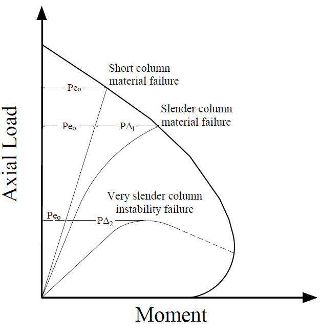

If I understand what your looking to get then a supplementary VBA routine on top of IDS’s spreadsheet is what you may end up needing.
If your column is non-slender then you can take your load point and project it vertically to the failure surface to get the Axial unity assuming no change in moment.
If your column is slender then you’ll need to iteratively step the axial load and perform moment magnification procedures until your failure line either reaches the failure surface or reaches Pcrit.

That's a great idea, and I can't see how it won't work.
It does require a little manipulation; I'll extract the loads from RISA-3D to a spreadsheet, factor the axial loads by 6.67 times and insert it along with the unmodified moments into SPColumn to confirm that the resulting points all fall within the 3D interaction design diagram.
