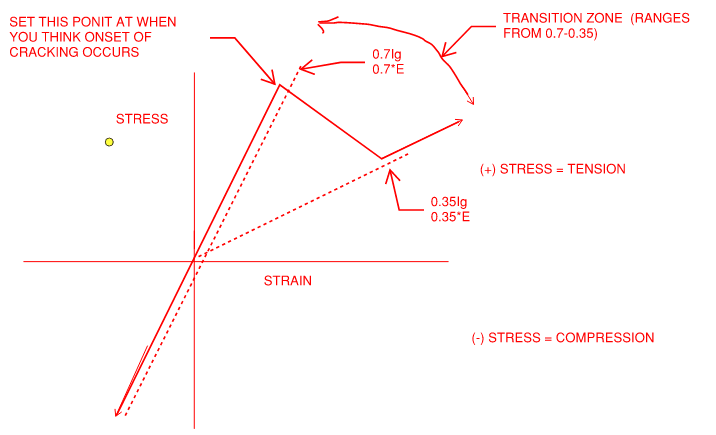

I couldn't connect stress-strain curve with this problem. Rather, IMO, the program needs to be able to compare the resulting tensile stress with concrete rupture stress. If the former exceeds the latter, then it shall calculate the revised moment of inertia using next specified depth (say "x inches" negative increment). The program shall stop when the moment of inertia has hitting the goal, say 0.7Ig. When compare tensile stress, it shall also keep an eye on compressive stress, and so on so forth... But this would still be considered "linear analysis", wouldn't it be?! So, no good.
i maybe in left field here... but I think the 0.7*Ig and 0.35*Ig is a convenient remnant of past analysis techniques for frame type members. For a frame element (stick) it is very easy to access Ig and modify as required.
For shell elements (how i would guesstimate 95% of concrete walls are modeled nowadays)... the concept of Ig becomes a little more fuzzy right ? The elements stitched together inherently make up Ig of a wall. A lot of literature suggests modifying E of concrete to account for the 0.35Ig of 0.7Ig. This inherently is inputting a stress strain curve whether we realize it or not in my opinion.
I think the technique that i have outlined above captures the heart of the 0.35Ig and 0.7Ig requirements for cracked and uncracked walls.
By inputting the explicit stress strain curve into the shell element, ETABs or sap should be able to check whether or not the shell element has cracked and then change the modulus of elasticity accordingly (hopefully in the end somewhat accurately (dripping with sarcasm here) capturing the softening effect of a cracked concrete wall).
Maybe a better stress strain curve would be this:

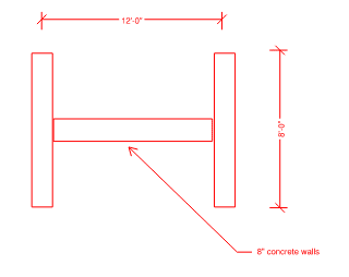

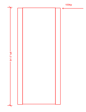

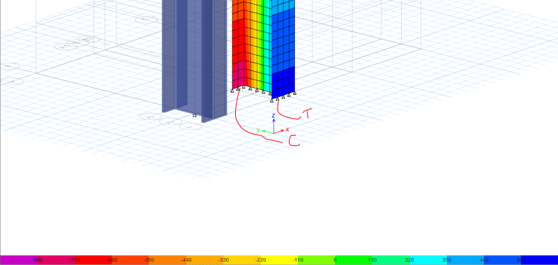

Some testing with layered shells and frame members... set up below:
Concrete shearwall plan view and elevation (100kips applied at the top of the core):

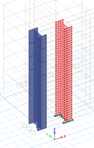

ETABs model with Stick element and shelled wall:
Stress strain curve for non-linear shell (finally took a stab at calc cracking stress at 5*root f`c for 4000psi concrete):
I applied a 0.7 and 0.35 factor to the stick element for Ig
Deflection results:
Stick element moves 1.45in (0.7Ig) 2.86in (0.35Ig), nonlinear shell element moves 1.82in at the top.
Stress results:
Tension maxes out at around 575psi, compression maxes out at around 880psi

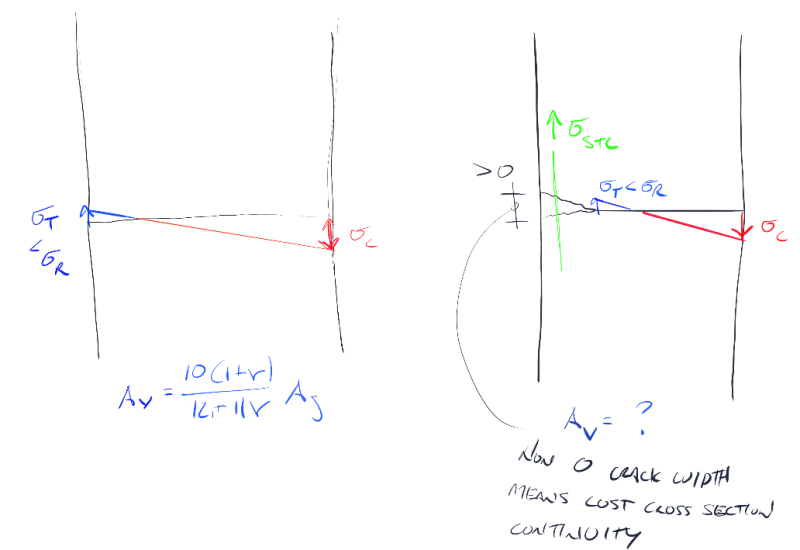

One thing that seems lost in all of this is these are technically deep beams and the contribution of the shear deformation is significant, how does the amount of flexural tension impact the "shear area", I haven't found much research on this topic which I tried looking into as part of my work on deriving general Timoshenko beam formulas. Most calcs I see on this just use the shear area for a solid rectangle if the fibers are separating under tension not sure this should really be the case.
I will work to post some results with capturing the reinforcing effects as well since that seems to be of interest. Maybe Trenno can give us some pointers on how to handle this.
The example I posted above I think could be used as a "poor mans" non-linear analysis that attempts to capture the 0.35-0.7 effects that ACI spits out.
I've thought about this as well but arrived at feeling OK with utilize the full solid rectangle area. Mind explaining why you feel that this wouldn't be the case?

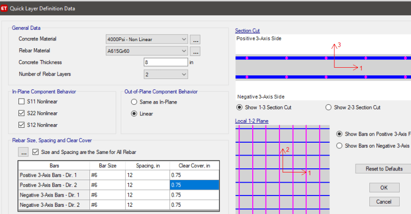

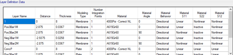

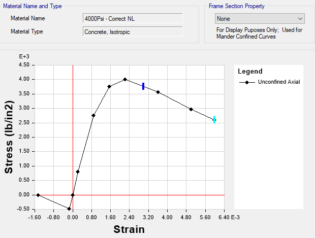

I deleted my previous comment for incorrect strain diagram. Is the stress-strain diagram below non-linear?

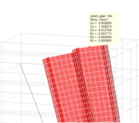

With rebar in the non-linear shells (which I have no idea how to setup correctly)... I get 1.35 inches of deflection at the top of my example.
Concrete Stress strain curve (note that it will drop off any appreciable load carrying capacity in tension):
Steel Stress Strain curve:
Nonlinear shell setup (#6 @ 12"oc ea way ea face):

celt is correct. The tension flange will be lifted up, and the stress redistributed on the un-cracked section.
Retired13:
I'm not sold on it either way as in theory for shear the tension steel should still be holding things together so you get the aggregate interlock mechanism across the shear plane, is that interlock enough to justify still using the gross shear area, not sure but nobody has done any different than that and buildings aren't moving crazy amounts.

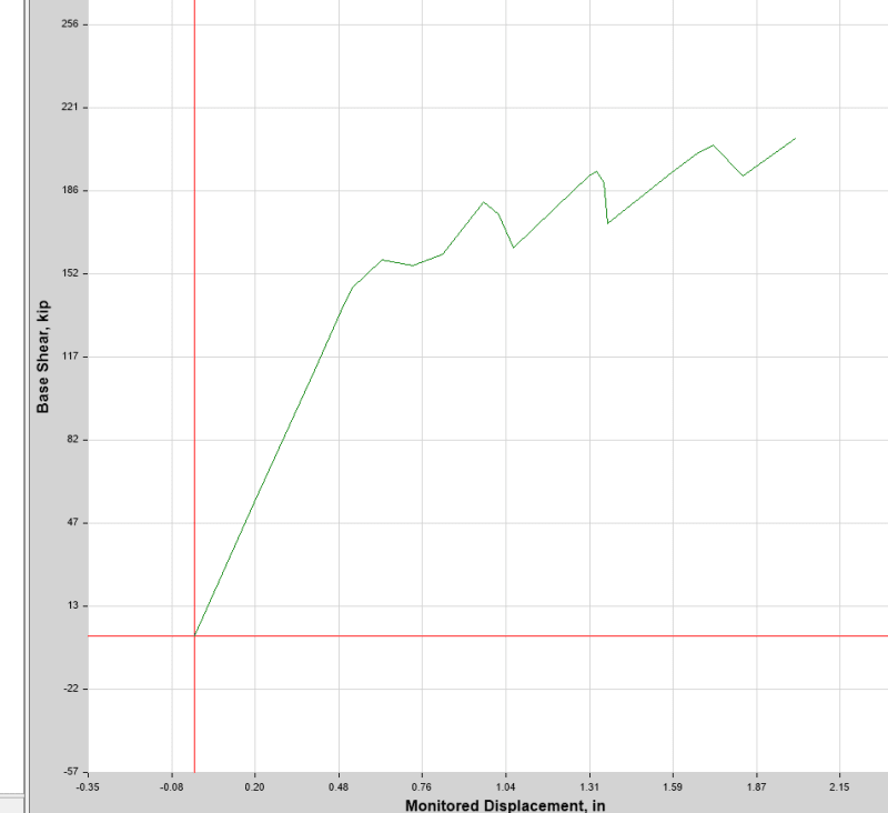

i did a quick pushover test for the layered shell (one directional push only).
Sorta of looks like the first hysteresis image posted by Josh.
Josh, is there a way to set this up to go back and forth like a hysteresis model in ETABs?
I would be interested in seeing what type of loop pops out.
