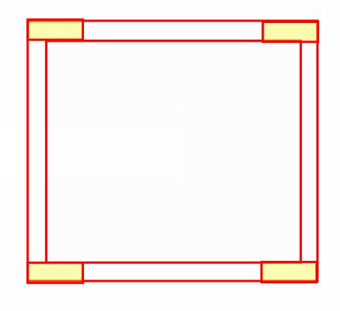

Correct me if I am wrong KootK, but I believe in this process the analysis considers the core's total stiffness, but design each face of the core for the load it experiences.
Unless I'm mistaken, I believe that you've described what I feel is one of the bizarre idiosyncrasies of the ETABS design process. Flexural capacity will be allocated as you've described above which:
1) Does provide enough aggregate flexural capacity.
2) Is not really how anybody would reinforce a compound shape, flexural member by hand and;
3) Results in more reinforcement further from the extreme tension face which would compromise stiffness to a degree.
As somebody said previously, this is just the best that we can do for now so we roll with it.

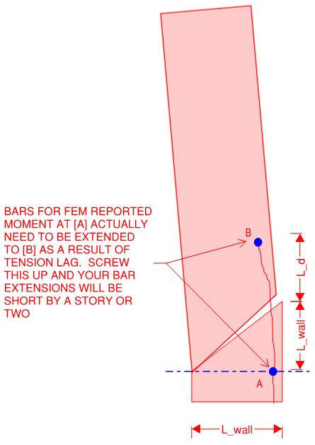

JP said:
What good is a 5% reduction in force from your analysis if you screw up the construction documents with bad detailing?!
The most egreggious detailing fail that I see routinely in FEM shear wall design is shown below. It's like our brains turn off shortly after our computers are turned on. This one's super easy to spot too. If I see that that somebody has terminated shear wall zone bar within the first couple of stories, I know that I'm dealing with the uninitiated.

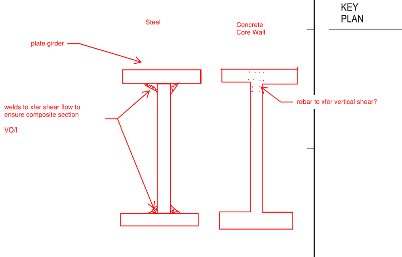

Just so I am clear on this longitudinal shear concept here... A few clarify images/comments:
For steel to make a composite section you need to ensure shear flow between the connected flanges and webs... is this the same for concrete core walls?
S&T

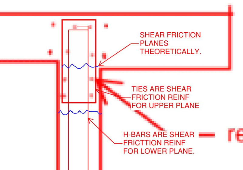

Almost. As I see it, it's your horizontal bars and zone ties acting as your SF reinforcing.
KootK, that makes senses on a shear friction check... my mind went to the vertical rebar type check similar to our longitudinal welds in plate girder.
The method I had in my mind would be difficult to figure out how many pieces of rebar are effective in resisting shear flow across a theoretical plane.
S&T
Thank you! I was about to write something similar. Then, I started 2nd guessing myself. In the low rise buildings that I've worked on, we usually designed the walls as if they were separate. Added in some end zones ties maybe. But, pretended the walls didn't connect with each other except at floor levels. Therefore, I figured it best to let someone else with more experience reply.... So, thank you for clearing that up!
You're most welcome Josh. Until EZbuilding building mentioned his longitudinal shear check, I'd been operating under the assumption that I might be the only engineer on the planet to have thunk this particular thought. And I'd encourage everybody to table this issue gently with their superiors and colleagues lest they be tagged with the career killing "over thinker / analysis paralysis" tag. I should probably get a T-shirt to that effect.
Actually, somewhere in Paulay and Preiestly's tome, I'm pretty sure that they look at a similar issue for the corners of basement walls when the basement is used as a monstrous, stabilizing box for overturning purposes. There, they conclude that vertical bar is required in the joint because the joint may not be long enough for an "around the corner" transfer of strut compression as is the case with taller walls. This is sort of heading in the direction that sticksandtriangles was heading I suspect.
