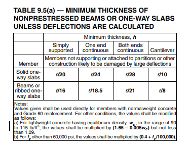

I believed 6" one way slab should work but considering minimum span to depth ratio per ACI, it doesn't look very accurate.
Those ratios are for transverse loads. How far will your slab be spanning between lines of support? With this be a CIP flat slab or slab cast on metal deck?

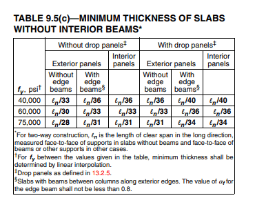

Table below is ACI recommendation for 2 way slab. Note in no case the slab thickness shall be less than 5" for flat slab w/o drop panel, and less than 4" for flat slab with drop pane. I think CBC shall have similar recommendation.

At a span to depth ratio of 30 (6" slab), that's starting to get up there for a uniformly loaded slab. This will actually be a transfer slab for the wood structure above, will it not?
Thickness of one way flexural members.
