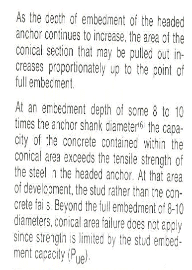

Yes, the studs need 8 to 10 times their diameter embedment for the pull-out concrete conical failure mode to exceed the tensile strength of the steel in the stud. When the slab / bridge deck is thick enough, the bigger the better. Larger diameter studs are more resistant to physical damage when they get hit during the placement of heavy rebar.

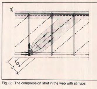

Now that's an interesting statement. My assumption, based on my understanding of how stud rails work, has been that:
1) On the compression face, the studs are restrained by a diagonal compression strut and the flexural compression block acting as a compression strut.
2) On the tension face, the studs are restrained by a diagonal compression strut and the flexural tension rebar acting as a tension tie.
In both cases, there would be no concrete conical failure mode as the studs would be restrained by reinforced concrete elements (struts and ties). There would be a development requirement, of course, but I thought that studs were developed right at the head/rail, similar to the case with a bearing plate. Can you supply a reference for the 8-10d conical failure mode business? I'd like to learn more about it. I apologize if that's in the Decon manual. I haven't read that cover to cover yet.
Additional thoughts:
1) This ties in with my question above regarding how concerned we are with the height of studs. Code requirements very much make it sound like the strut and tie model that I've described in which case full height studs would be rather important. In a breakout cone scenario, one ought to be able to tolerate short studs, so long as their anchored either side of the diagonal tension crack.
2) There's an analogous situation in common beam stirrups that has always bothered me. To be code effective, a stirrup only needs to be developed either side of the assumed diagonal tension crack. Somehow, it's not necessary for them to be developed across the compression block / tension tie as seems to be the case with studs and as one would expect with a truss model in play. Often, with smaller bars, they are developed across the truss chords but, per code, they don't have to be.
KootK - I thought that statement might get your attention...
This comes from page 8 of the 1977 Nelson Stud Design Manual that I linked to in my "27 Nov 15 19:10" post. Read the Introduction and pages 8 and 9, for sure... and don't pour that concrete until the "mess" in the field is straightened out. [wink]

The thing with the Neslon catalog information is that it is speaking to studs that are anchored by some form of concrete tension. It's the pre-App D version of AppD.
As I described above, I believe that stud rail studs are anchored by a different mechanism: the struts and ties that make a reinforced concrete slab reinforced concrete.
Consider the not so trivial example of a 1/2" stud in my 10" slab (d~8"). At 10d = 5" either side of the assumed diagonal tension crack, I wouldn't be able to anchor even one stud per diagonal tension plane.
Ok... I won't dispute that studrails may be different, but what I take away from the Nelson manual is that full-embedment of the studs (no matter what their length relative to diameter) is important. For studs that are intentionally embedded less than 8 - 10 diameters full embedment is even more critical. If conduit is immediately adjacent to studs... there goes meaningful full embedment. I see that as a problem.
