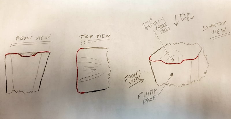

Here is another example.
This is typical geometry of a grooving insert. The cutting edge emphasized in red. Unlike in the case of the blade which was dealt with by drawoh, where opinions were expressed that it can be succesfully defined by the means of profile controls without any additional standardized modifiers/notes, the outline of the cutting edge in this case doesn't appear as a straight line in every view. Therefore in my opinion, can't be described through 2 flat tolerance zones for a line element intersecting at the theoretical "true" edge. For cutting tools the wedge angle (between the flank and the rake faces) is usually less than 90°, and what you see in the top view as a straight line is not the entire flank face, but only the edge. Sometimes the flank is not a flat face at all, and includes a "compensation" convexity so that the edge remains straight enough in spite of it's dendency tendency to become concave because of the effect of the chip breaker's concavity. What should be inspected is the location of the cutting edge relative to datum features, it's resultant straightness (in the top view), and orientation (such as perpendicularity) relative to datum features.
Do you think that this case can be dealt with without the "PROJECTED EDGE" modifier, and a note specifying the projection direction (which can be defined by the means of fixed orientation in relation to datum features)?
Sem_D220,
You have a top surface and front and side surface all of which can be controlled by surface profiles. The sharp edge is where these faces intersect. Is that a problem?
The sharp edge needs to be controlled by some cutting test.
JHG
drawoh,
Controlling the cutting edge by applying surface profile on the intersecting surfaces is an indirect method to control edge geometry and it is both more complicated and less reliable.

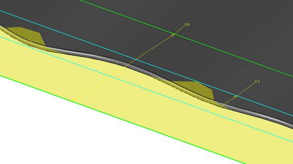

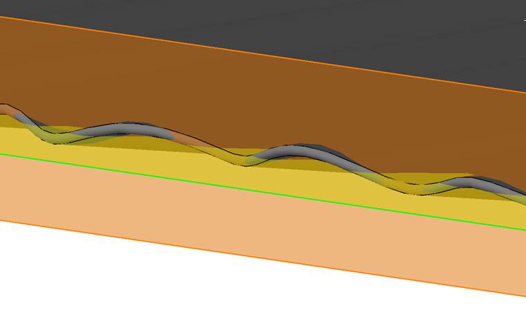

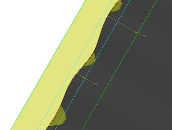

drawoh,
I modeled a possible as-produced edge for the blade drawing you made. It seems like any real edge produced will fail to fall within the 2-dimensional profile of a line tolerance zones. Please check these pictures:
The yellow transparent tolerance zone in the first and second images is the 0.4 profile you specified. The blue limits are the straightness refinement. The transparent orange tolerance zone in the last picture is the 0.2 profile from the other view.
There will always be portions of the edge outside both tolerance zones, regardless of how accurate it will be produced.
For the profile tolerance zones to be understood as you meant them to be, and as they are applied in reality, they should be applied on a projected outline, and not as defined by default in the standard.
3DDave will claim I want a "magic wand solution" but there is actually nothing magical in Dean's suggestion, only making the standard a little bit more in line with the reality and methods that are already well established.
