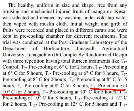

FMJalink: thank you for your time. Its not going to be only for mangoes, it is just an example, anyway the fruits part is less my business . i just want to determine the energy that is needed for that, calculating the mean tempeture of the mangoes after two hours in 10c can be good, do you know how to do it?

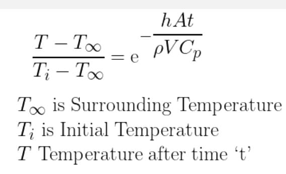

Maybe an approximate calculation would be for one mango with this formula:

Yes, it will be a formula as you mention. Formulas will give an indication only, as they idealize the situation. The fruits will not be all of the same size and will have different heat conduction coefficient, etc.
Personally, I would try following approach to obtain data that I could use to evaluate the cooling process. Pending on the size the fruits, they will get cooled throughout or not during the pre-cooling. The fruits will probably be placed in cooled storage after pre-cooling. There fruits could be further cooled in nearly stagnant conditions.
I would try to couple theoretical approach with test results. For the approach I would use Excel with VBA software.

Wow amazing, this is exactly what i needed, even the example inside is 2 hours of cooling. i guess now i will make several calculations . The best case scenario would be for a temperature of a normal size mango, then assuming this temperature for all of them . The worst case scenario would be treat 1 ton as one big sphere since they are all in one big pile without much space between them. And then some cases in between those extremes .
After coming up with the temperature change, easy to calculate the change in the internal energy( which is the heat) adding the heat respiration and the leak from the outside will sum up the approximate power needed.
