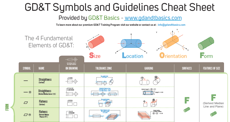

I notice that their GD&T Wall Chart has a huge goof. They give the acronym S.L.O.F. as Shape, Location, Orientation, Form. Any GD&T beginner should know that it's Size, Location, Orientation, and Form (Shape and Form mean the same thing).
Garland23,
Do you have a proof of your above statement? I have their GD&T Wall chart and does not look like there is exactly what you just said above.
I see size, location, orientation and form listed as the 4 fundamental elements of GD&T
Looks like they got it correct. I didn't feel like submitting my email info to get the real chart, so I was looking at their preview image, which had the goof. My apologies.
Garland, it's their advertising; not your fault.
