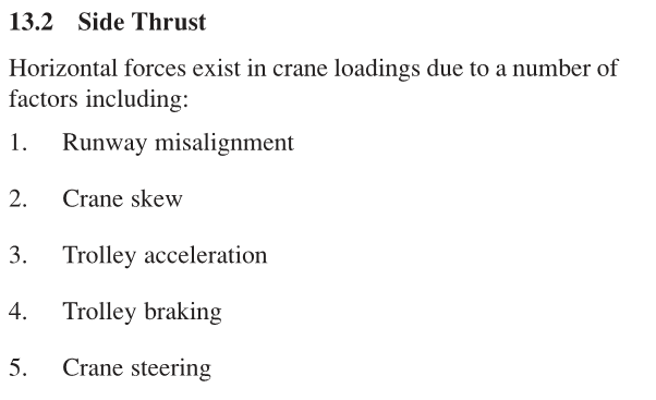

I already have have. AISC DG 7 calls it a source for lateral/horizontal forces and gives deflection criteria for the same.
I disagree that the AISC blurb should be interpreted that way. They basically just dump a bunch of lateral load sources in a bucket and then, seven pages later, rattle off some generic deflection suggestions clearly regurgitated from CMAA.
What about the Ricker paper? Right after mentioning skew (among other things) he rattles off that pesky deflection criteria.

To backup a little bit; it seems that OP has two main questions to ask here:
[ol 1]
[li]Does the structure deflection exceed the requirements in the applicable specifications (CMAA, etc.) when analyzed in a traditional fashion?[/li]
[li]If it does, can we justify that the serviceability of this crane as acceptable if we perform a more rigorous analysis?[/li]
[/ol]
For item (1) many engineers would likely not step outside the cut and dry boundaries of the spec for a more grey area. If OP is correct in his analysis then it appears that he cannot utilize the stiffness of the stronger rail without entering such a grey area.
But, if OP is willing to step into this grey area, here's how I believe you could justify this:
I agree with KootK that the appropriate analysis of side thrust would be CMAA's breakdown of the various side thrust forces. I would put forth that the overall goal of the lateral deflection criteria is to avoid extreme curvature of the rails such that you had excessive wear or binding of the end trucks. With that goal in mind, I believe we can indicate which of the CMAA loads would and would not be able to distribute load to the stiffer rail:
[ol 1]
[li]Runway misalignment lateral load inherently requires both end trucks to be engaged for a lateral force to be present. Thus, we could distribute this load to the rails based on stiffness.[/li]
[li]Crane skew is independent to each rail. Thus, we can not distribute the skewing force based on stiffness.[/li]
[li]Trolley acceleration could load up only one rail depending on which wheel cheek was resting against the rail and which side of the bridge the trolley was on. Thus, we can not distribute this force based on stiffness.[/li]
[li]Trolley braking is similar to acceleration. We can not distribute this force based on stiffness.[/li]
[li]Crane steering is related to crane skewing and similarly we could not distribute this load to the rails based on stiffness.[/li]
[/ol]
If practical, I would run the calculation for these forces and distribute them to the rails based on the above. I would then see if I still violated the crane rail deflection criteria.
Here's a nice paper on free floating vs. fixed rails that's relevant to this discussion:
Short version is they conclude that adding rail guide rollers (as KootK mentioned way above) is an ideal solution and done often across the pond. I would put forth that adding rail guide rollers would be a suitable alternative if OP cannot meet the lateral deflection criteria.
Other than proximity, this looks the same to me as the design guide. Bucket-o-stuff --> blanket recommendation. But yeah, if my previous proximity argument held any water then I guess this does too logically.
Agreed and sounding better all the time.
TME said:
1) Runway misalignment lateral load inherently requires both end trucks to be engaged for a lateral force to be present. Thus, we could distribute this load to the rails based on stiffness.
I'm not so sure that it does require both end trucks to be engaged. You could be generating your force by running at an angle to your misaligned rail on one side while having any movement be accommodated by a low friction gap on the other side. I'm not so sure there really is such a thing as a low friction condition but that seems to be what we're running with so I'll not rock that boat.
TME said:
2) Crane skew is independent to each rail. Thus, we can not distribute the skewing force based on stiffness.
My argument is that there's no need to distribute the force because, once both ends of a truck are engaged, skewing doesn't actually produce a net force (other than moment) at the trucks.
TME said:
3) Trolley acceleration could load up only one rail depending on which wheel cheek was resting against the rail and which side of the bridge the trolley was on. Thus, we can not distribute this force based on stiffness.
4) Trolley braking is similar to acceleration. We can not distribute this force based on stiffness.
I think that you can distribute based on stiffness once any gaps are closed. Furthermore, I contend that all systems have to be able to deal with gap closure so it's spurious to think of gap closer being a problem here. As I noted in my last post, gap closure may require truss stiffness to be greater than L/400 in order to keep the non-truss runway beam to an L/400 curvature.
I think that we're going a bit off the rails here in that we're now focused on forces. The OP's question pertains to deflection criterion for the forces which is a bit different.
Forgive me if I'm dubious; I only see significant lateral load due to rail misalignment being generated when the cheeks of the wheels on opposite end trucks start rubbing on misaligned rails.
After some thought, I'd agree with you on this.
I'm not yet on board with this but I may have simply caught a case of the Fridays and be missing something.
Well, forces causes the deflection and the forces are what could be distributed via stiffness of the rails per OPs question. Sorry if I got us on a tangent.
