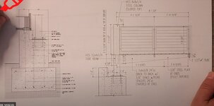

I found this video on youtube. What do you think of this deck? The guy went to the end of the deck and jumped a little bit, you can clearly see the deck moves up and down. At minute 3:55 he shows the structural detail.
I love it. Sure, some vibration. But it's a clean and simple load path to design and trust. And the building envelope angle is slick. Even drainage slope on the top of the HSS.
Plus he gives us his details. I don't love the j-bolts in tension and feel that the footings are a little small for the OT but, whatever, if it works it works.

The hold down bolt detail looks weak though - look how much reo is in the foundation relative to the shallow bolts
I would have cast in 500mm long bolts for that - not like the rods are expensive but would help me sleep at night

Crunching some numbers based on his drawings:
Width = Joist at 600mm cts x 8 = 4.8m
Length = 2.5m
assume DL = 0.5kPa, LL = 2kPa
Design UDL = 1.2 x 0.5 + 2 x 1.5 = 3.6kPa
Max Moment per column = 3.6 x 4.8/2 x 2.5^2/2 = 27kN.m
Column: 200SHS
Tension on each anchor bolt = 27/0.2 x 0.5 = 67.5kN
The anchor bolt tension is decent but nothing concerning.
I'm more concerned if the footing supporting the post is a shallow isolated footing, he might need to get it checked such that it wont rotate due to the pure bending moment being applied by the post.
Actual bolt lever arm is probably 250-300mm as they're outside the SHS, but it's a decent estimate
Not gonna lie, 67.5kN (or even 40-50kN) PER BOLT is quite concerning in my eyes
They're really shallowly embedded
Even if it calcs out, it seems to me that the weakest element in the design is the hold down bolts which isn't a great philosophy
Also, 67.5kN is a decent tension demand - what size are the bolts, I can't read the detail as it's blurry
Could the bolts yield in tension?

I zoomed in, it looks like 3/4" dia.

I couldnt read the details on the bolt. Hopefully they are 20mm dia, those usually work around 60kN if edge distance is at least 100mm.
Wish they could record a load test on it. install a spa/tub fill it 200mm with water, see if it works. He could title it "pushing the bounds of engineering for thermal efficiency"
You wonder why he didn't make the plate on the base of the sport a bit larger to bring down the holding loads.
I did think that but then the house is sat on the rest of that pad.

In it's initial constructed state perhaps the numbers work out.
But this is outdoors and over time there will be concrete weathering and degradation.
It's in Columbia, Missouri, so freeze-thaw deterioration is a possibility - especially on a flat surface of concrete around the bolts.
Once the concrete cracks things will get worse very fast.
"J" bolts don't look right - agree with above that a deeper embedment would make me feel better.

I share others' concerns about the AB size/embed. Also curious about the welding of the angle to the HSS.
An 8'-0" cantilever does not seem that notable. Finding someone to pay for this on your typical residential project seems the hurdle. That anchor detail is terrible.
Watched the presentation a 2nd time. Noticed the edge joist is a single angle, not a back to back. Bothers me a little due to torsion.
