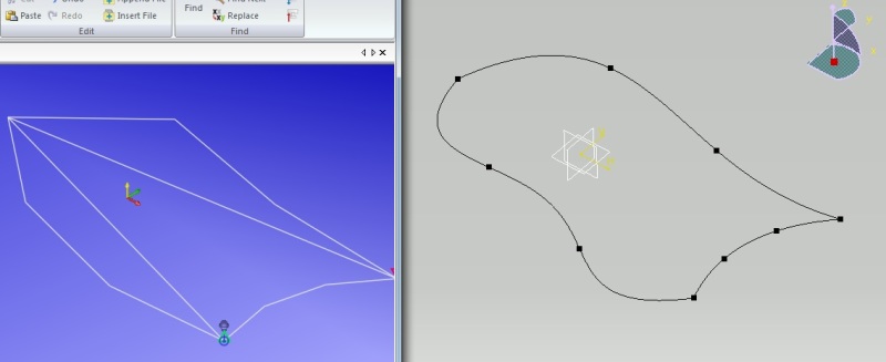

recording macro for creating points doesn't work for me, moreover marco records entities names. not good for me.
can anybody share sample macro for creating points on curve? needed for composites (laser projection)
thanks in advance.

Points on curve
Code:
Sub CATMain()
Dim oPartDoc As Part
Set oPartDoc = CATIA.ActiveDocument.Part
Dim sSel As Selection
Set sSel = CATIA.ActiveDocument.Selection
'multiple geosets are selected
Dim oCurveGeoset 'as HybridBody 'Geoset that has all the curves
Dim oPointGeoset 'as HybridBody 'New geoset for the points on the curves, I am just guessing that you want this
Dim oCurve 'curve points will be added to
'Dim sResponse 'The number of points you want on the curves
Dim iCounter 'To make sure you dont get into an infinite loop
Dim oPoint As HybridShapePointOnCurve
Dim oGSD 'As Factory 'for accessing Generative shape design functions
Dim lRatio 'Ratio for spacing out points
Set oGSD = oPartDoc.HybridShapeFactory
'loop through selected geosets to get curves
For I = 1 To sSel.Count
    Set oCurveGeoset = sSel.Item(I).Value
    'You need to know how many points to put on the curves
    'This will ask the user once for each geoset
    'Maybe you want to do it automatically...maybe you have a standard
    'Like you want a point every 1 mm on every curve
    sResponse = "A" 'set to a non-number to get inside of the following Do Loop
    iCounter = 0 'Used to limit the number of tries the user gets to enter a number
    Do Until IsNumeric(sResponse) = True And Val(sResponse) = Int(Val(sResponse)) 'Make sure user enters a number that is not a decimal
        sResponse = InputBox("Enter the (integer) number  of points to be placed on each curve in this geoset")
        If iCounter = 3 Then 'give user 3 chances to enter a number
            MsgBox "You did not enter an integer, exiting"
            Exit Sub
        End If
        iCounter = iCounter + 1 'Increments the counter if user keeps putting in non numbers
    Loop
    'Calculate ratio
    lRatio = 1 / (CInt(sResponse) - 1)
    Set oPointGeoset = oPartDoc.HybridBodies.Add 'Add the geoset
        oPointGeoset.Name = "Points for " & oCurveGeoset.Name 'name the geoset
    'loop through curves to add Points
    For j = 1 To oCurveGeoset.HybridShapes.Count
        Set oCurve = oCurveGeoset.HybridShapes.Item(j)
'        Set oPointGeoset = oPartDoc.HybridBodies.Add 'Add the geoset
'            oPointGeoset.Name = "Points for " & oCurve.Name 'name the geoset
            'If you name the point geosets a specific way with this macro, you can get them automatically
            'When you create the text file, you won't need to select them;)
        'Loop to add points at multiples of the calculated ratio
        For k = 0 To CInt(sResponse) - 1
            Set oPoint = oGSD.AddNewPointOnCurveFromPercent(oCurve, k * lRatio, False) 'Add the point
                oPoint.Name = oCurve.Name & " Point " & k + 1 'name the point
            oPointGeoset.AppendHybridShape oPoint 'Make the point appear in the tree
            oPoint.Compute
        Next
    Next
Next
sSel.Clear 'Clear the selection
End Sub

about points creation macro. i did a change in geo set creation. changed it to Set oPointGeoset = oPart.hybridBodies.add()
and changed oGSD to oHSF
works well but macro creates geo set for each curve. i need all the point in one geo set.
i also changed lRatio = 1 / (CInt(sResponse)). if you use lRatio = 1 / (CInt(sResponse) -1) macro creates points outside a curve if you enter to much points in dialog box
later i'll combine all that together.
i really appreciate your help
cheers.
Interesting how FileSysetemObject is not working for you.
Funny...when I ran it with lRatio = 1 / (CInt(sResponse)) it created points off the curve.
Yes, oPartDoc should be oPart...I figured i would leave it since you already had it set up that way. But a part and a part document are different...so it would be best if your variables matched what their type is.
See below for only making one geoset...you just need to move the geoset creation out of the loop. Hopefully you can use this to start to learn how to piece things together. Do you have the V5Automation.chm file? That will help you. You can also check out w3schools for online/realtime examples of VBscript.

attached combined macro. this will let to select curve, create points and export them
 http://files.engineering.com/getfile.aspx?folder=17ed1276-6f70-4ee1-b355-094c3c837969&file=TestInWork.bas
No I have not tested it, I have lots of my own coding/work to do at work:) I do this from memory and let you test it, hopefully it will help you learn. Need to be careful what you run from the Internet...if it has viruses or changes the environment, there can be big trouble.
The code you posted it in a loop? If you only want one geoset, Take the first 2 lines of code out of the loop and remove I from the name in the second line. That should put all the selected curves into the same geoset.
sure i learn a lot from yours post..thanks a lot for the help. it's not so easy to find an info over the Internet.
i'll try to move the lines and will let you know how it's going.
actually i'm coming from CAM software(Cimatron and Nx) and from post-processors development but it's different from VBA. that is why i got so many questions. for the past few years only Catia primary composites and tooling design for composites and sheet metal.
cheers and have a good weekend.
don's worry about exe. i work with it everyday. if system blocks it just rename txt to exe.
points creation and export works good except one thing. macro exports points in an order like it's located in a tree. i need to export point in cw or ccw direction in other way laser will not understand a code. with goto command followed by coordinates laser creates closed contour
