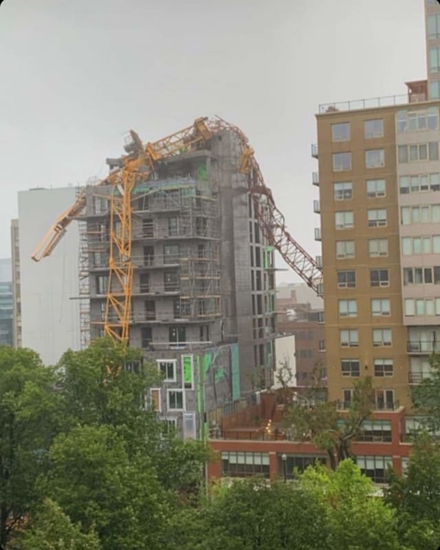

Here's the crane. There's a video of it actually falling over online, above post.
VEIBill; Interesting collapse that, the droopy wet-noodle look. Seems quite different from the latest collapses where they break up with pieces going all over to cause more ground mayhem.

They stick together when the bolts aren't taken out.
At least that one fell and punished its own building, rather than somebody else's.

I'm a little surprised though, they had to know this was coming, unlike most those other crane disasters, and yet they couldn't come up with a solution to protect their million dollar crane.
Couldn't they tether it to the building or guy wire it to something?

Not weathervaning substancially increases gust load. Tethers not good.
Perhaps Halifax city officials are still reviewing the operator's application to shore the crane for extreme weather protection? [hourglass]

I think the building that the crane was on was not the one it fell onto.
One thing the building owner said was 'Good thing it landed on my building, which is unoccupied; it's just a matter of money to fix it, no people were harmed'.
Maybe I came to the wrong conclusion from the photos. Can someone who knows confirm whether or not the collapsed Halifax crane was being used in the construction of the building which it fell on?
