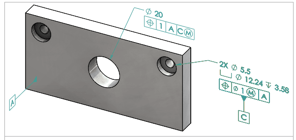

Datum feature symbol attached to a callout common to hole and c'bore/sink 1
Burunduk
May 2, 2019
2,580
When a datum feature symbol is attached to a callout common to both the hole+counterbore or a pattern of them as in This example or to a hole+countersink or a pattern of them as in this example, is there any rule in ASME Y14.5 or related standards that tells clearly that the datum feature is understood to be the hole(s) and not the counterbore/sink(s)?
Or maybe it's vise-versa?
Or maybe it should be understood that both features/patterns act as a "common datum feature" (of hole+c'bore/sink, repeated in pattern if applicable)? Are those placements of the datum feature symbol unambiguous? I tried to find something about it in Y14.5 with no success, but maybe I'm missing something?
Both examples are from here.
For some unknown reason (at least to me), Y14.5 does not provide a clear answer to this question.
My opinion, based on the rule for applicability of a single FCF in the hole-counterbore case, has always been that the datum feature symbol attached this way defines both features - the hole and counterbore/countersink - as datum features, which in many (most?) cases makes no functional sense. Therefore, I would avoid using this method of datum feature assignment in such instances.
Unfortunately, I have seen GD&T materials available for free in the internet these days (which are very popular) that seem to care very little about it and keep showing examples like the ones you brought up without any caution remark.

Could the lack of a rule or standardized convention for these cases simply be an oversight? Do you think it could be that the possibility of placing a datum feature symbol on such FCF never crossed the committee members' minds?
The examples are actually from SolidWorks MBD help page, I think it's even worse than if it was from some questionable free "GD&T" training source.
I don't think this never crossed the committee members' minds. I lean towards saying that they don't see a problem with it, i.e., that in their minds the standard provides all necessary information to be able to clearly interpret the datum feature placement method.
But they are wrong, aren't they?
Even with the common callout,
the cylindrical holes and the countersinks or counterbores are still two different patterns of two different features (even if not entirely separate, since a simultaneous requirement makes the two patterns become part of one pattern, that includes both the cylindrical holes and the countersinks or counterbores).
In the examples I brought, does the common callout imply that the 'B' datum is established based on two datum axes, each of which is common to the cylindrical hole and its respective counterbore/sink per the "common datum features" concept? I don't see anything in the standard that may clearly indicate that.
However, the standard provides examples based on which one can probably easily come up with a solution for a situation where the intent is that the holes and counterbores/sinks ARE NOT common datum features, doesn't it?
Using the counterbore example,...
-- if the intent is to define the 2 holes only or 2 the c'bores only as datum features, then separate the c'bore size callout from the hole size callout, associate each of the size callouts with a positional FCFs of the same value and then apply the datum feature A symbol to just one of them. This would be a variation of the approach shown in fig. 10-26 in Y14.5-2018.
-- if the intent is to define only a single hole or counterbore as datum feature, then keep the size+position FCF callout as is but associate the datum feature A symbol with that specific single feature only. This could be a variation of the datum feature C specification from fig. 10-27 (just with the omission of the 8X INDIVIDUALLY note) or the application of the technique shown in fig. 6-4(i).
Am I just playing a devil's advocate here? ;-)

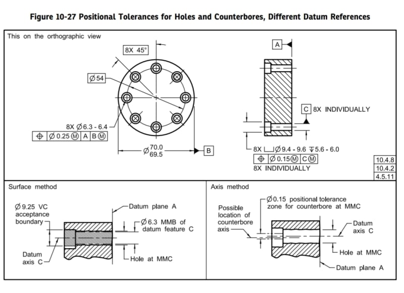

supergee said:
Personnaly, in such case, I would create a section view of the hole and dimension the counterbores seperatly from the clearence holes. I would then use the clearence hole as datum. If possible, I would use a profile of a surface to locate and dimension the counterbore.
Just curious, not that it's wrong, but why profile of a surface and not a directly toleranced diameter dimension and a position tolerance for the counterbore?
supergee said:
if not, I'd locate the counterbore to the hole individually.
Wouldn't it be "individually" in the first case too? Or did you mean in the first case that the holes are position-toleranced with ref. to A and used as a pattern datum feature B, and the counterbores are also position-toletanced as a pattern to A, and therefore in a simultaneous requirement with the holes?

As I said, if possible. I don't know the actual use of that counterbore. I teach my students that tolerance of form is magical because it controls form and position. I doubt that there is a fit requirement on the counterbore diameter itself. since ASME says it's trying to move away from direct tolerancing to geomtric tolerancing I tend to use profile of a surface when ever possible. But it can be replaced with a ± tolerance + location. rule #1 will control the form.
In the image shown, the datum is applied to the feature control frame that relates to two holes (2X). This implies that both counterbored holes, together, form the datum. I propose that we separate the counterbore callout from the clearance hole dimensions. This means that we need to ask ourselves if we want to locate the patern of counterbores (PLTZ) with regards to the the true location of the the clearence hole or if we want to locate each individual counterbore with it's own clearence hole. I believe that the second option is the one we typically would like to do.

Hello Burunduk,
I had forgotten about that example in the standard, and it is exactly what I had in mind. the difference is that the image shown initially the datum C is establish on both hole as show in the picture below. so datum C is not on one hole but on the pattern of the two holes. in figure 10-27 of y14, it would be equivalent to locating the bore with datum A|B(M) which makes not a lot of sense
