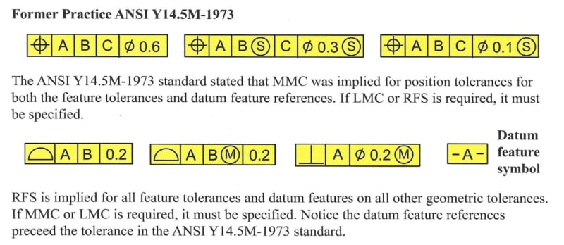

Hello,
I was wondering what this symbol represents marked in yellow. can someone help me understand the correct terminology for it?
This is from a very early edition of Y14.5 and is a datum feature symbol.
When was the drawing made? I'm expecting it was done before 1970.

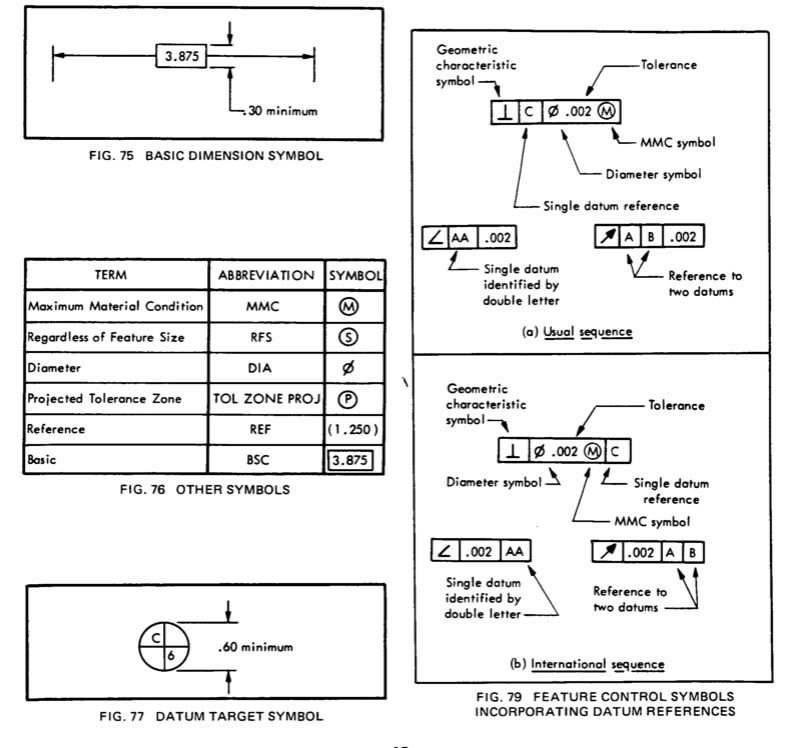

Edit: That would be ANSI Y14.5, before ASME took it over. Note the order of the elements in the feature control frame with the datum reference before the tolerance.
That's an earlier version.
Edit : please note the datum feature reference is placed on the 2nd compartment on that time.

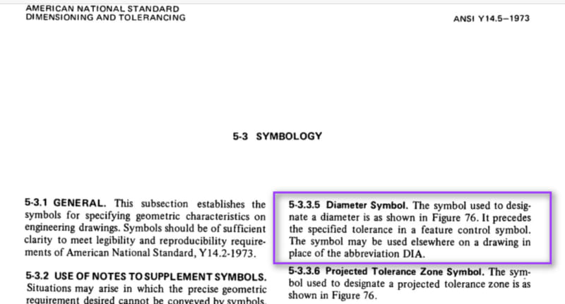

Could the "DIA" text following the tolerance value instead of the diameter symbol before it also be attributed to the old age of the drawing?
I remember in the hand drawing days "dia" was written because some thought it confused true position or concentricity. It was only a preference by some.

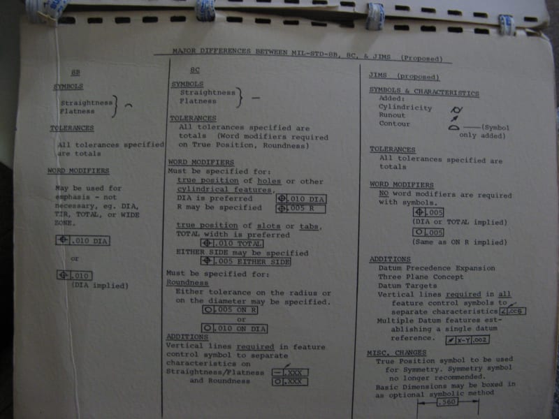

This callout would comply with MIL-STD-8C that was taken over as ASA Y14.5-1965 "Dimensioning and Tolerancing for Engineering Drawings" as a Joint Industry-Military Standard. (JIMS)
See "A Treatise on Geometric & Positional Dimensioning & Tolerancing" by Honeywell Regulator Company, authored by Lowell W. Foster, Senior Standardization Engineer at Honeywell Inc. 1963 and revised through 1965.
SeasonLee, 3DDave, thank you both for the references to past standards.
3DDave, I see that JIMS was referred to as "proposed". Was there eventually a document titled ASA Y14.5-1965 released?
In the sources I read there was ASA Y14.5-1957 and then the next "Y14.5" mentioned is USASI Y14.5-1966. Could the 1965 ASA document be a reaffirmation of the 1957 edition or something? EDIT: I guess not, because it seems that the 1957 standard was based on literal notes such as "LOCATED AT TRUE POSITION WITHIN..." and possibly had no feature control frames or symbols for the geometric characteristics at all.

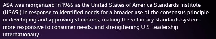

I cannot confirm documents I don't have and/or have never seen. It is probable that the 1965 and 1966 are the same document, moved from ASA to USASI the way that Y14.5 was moved from ANSI to ASME; USASI stands for United States of America Standards Institute (now ANSI) No one appears to have released the 1965 version which Foster was working on releasing under the old group name.

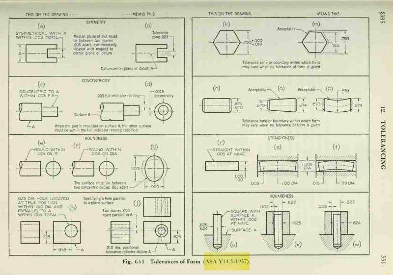

My source for information on ASA Y14.5-1957 is Technical Drawing by Frederick E. Giesecke, 4th Edition, 1958.
This is how some of the geometric tolerances (which were all called "tolerances of form" at that time, seemingly) are presented in that book, with an identification of the source being ASA Y14.5-1957:

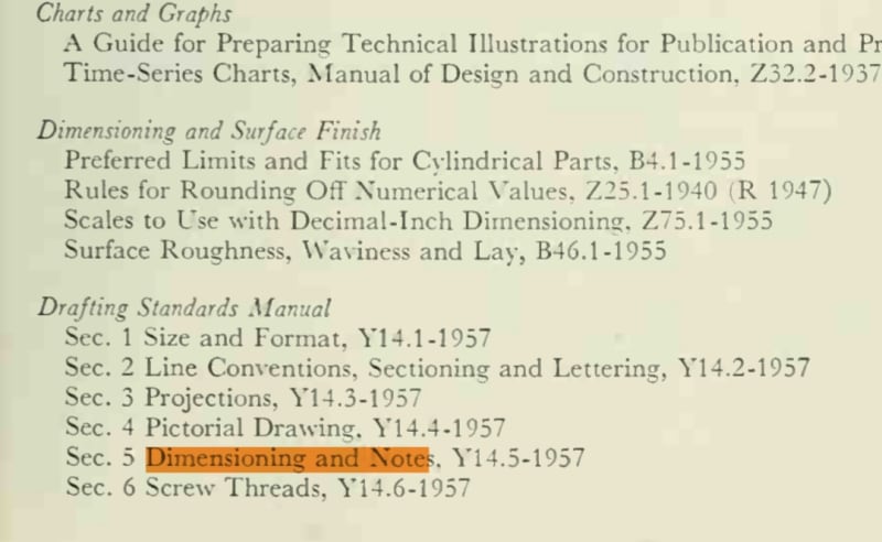

Also worth noting that according to the same source, the title of the 1957 standard was "Dimensioning and Notes"

Many of the controls did have symbols associated with them, but without a copy of the 1957 version (none of this matters in the slightest) it doesn't matter.
I do like what appears to be the origin story for "Geometric Tolerances"
Geometric Tolerances. Geometric tolerance, or "tolerance of form" specifies "how far actual surfaces are permitted to vary from the perfect geometry implied by drawings."* The term "geometric" refers to the various geometric forms, as a plane, a cylinder, a cone, a square, or a hexagon. Theoretically these are perfect forms, but since it is impossible to produce perfect forms, it may be necessary to specify the amount of variation permitted. Geometric tolerances define conditions of straightness, flatness, parallelism, squareness, angularity, symmetry, concentricity, and roundness.
*ASA Y14.5-1957.
They did not include Position tolerance. Makes the whole GD&T term seem even more inaccurate.

Since it is very expensive to maintain accurate geometric tolerances in the shop, tolerances of form should not be specified except when established shop procedures cannot be depended upon to produce the necessary accuracy.

I have no proof, but I think "Dimensioning and Notes" was all about dimensions and notes.

Y14.5-1957 does not define symbols. All tolerances of "form and position" are defined through notes.
Thanks pmarc.
Then it appears that the military standards (MIL-STD-8...) had geometric characteristic symbols before the general industry standard (... Y14.5) incorporated such symbols (and the military standards were incorporated into USASI Y14.5-1966).
