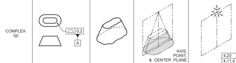

Please see the following diagram.
Do you think, based on the Y14.5 standard, that the shown curved line could be a valid datum corresponding specifically to the "line" type (and only) in the above definition? If not, why?

Would you classify datum feature A as a "complex feature" (as 3DDave did) - which constrains all 6 DOF? Or do you think a secondary datum reference had to be used to fully define the location of the holes relative to a datum reference frame?

My second question was - does datum feature A belong in the category of "complex feature" that constrains 6 DOF as shown in fig. 4-3 in Y14.5 '09 or 7-3 in '18:
I'm also not sure what point were you making in your response to the first question. It's clear that an axis is also a line. The purpose of the first question was not "debating Axis vs Line", it was to find out whether a line that does not meet the convention of what an "axis" is (in the example, because it is curved), can be a valid datum per the quoted datum definition. Do you think the shown line can or cannot be considered a 'datum'? Thank you.

Is the part in your example a bent cylinder or an extruded shape? If the latter, then I don't understand why the question is about the line as indicated. If the former, then the datum feauture A is a portion of torus that ends up being the same type of datum feature as cone. Table 7-3 in Y14.5-2018 explains datums for this type of datum feature and none of them is curved line.

The shape of datum feature A is a nominally bent cylinder.
If this is not an example that can justify the mention of a line (alongside axis) in the definition, do you believe there could be another example? Or is the mention redundant since "axis" covers all possible cases that could ever be attributed to "line"?
I agree that this torus-shaped datum feature has something in common with a cone - 5 degrees of freedom are constrained and one rotational degree of freedom remains.
In my example, it is manifested by the fact that holes accurately spaced and centered to the spine of the torus-shaped TGC could end up anywhere along that spine and pass as conforming. That would not be the case with a "complex" datum feature.
