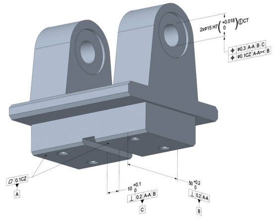

In this case, Datum B is a group of four faces. Should I use B or B-B?
I have always used B in cases where I use the CZ modifier, and in my mind B-B should not be necessary to use since the four surfaces shall be interpreted as one surface already.
But recently one of my colleague attended a GPS training course and the trainer told my colleague to use B-B. So I'm a bit confused, because I cannot find any examples of this in ISO. I have used "B-B" for e.g. hole patterns. So if anyone can point me to where I can find what I'm looking for in the standard, I would appreciate it very much.
I'm working with ISO GPS, but I assume there are some similarity between ISO and ASME in this regard.

Unfortunately, in this area (and in a quite few other areas) the two standards are not similar.
Per ISO, B-B is the correct choice. See ISO 5459:2011, if you have access to it.
Yes, I have access to ISO 5459, could you point me to the paragraph in the standard where I can read about this?
Could potentially end up with a pretty nasty(in my mind) tolerance box, like |A-A|B-B|C-C|, but I guess that how it should be.
Out of curiosity, how is this done different in the ASME standard?
See para. 7.4.2.7 - Rule 7.
Yes, it could potentially end up with |A-A|B-B|C-C|.
In ASME it would simply be |A|B|C|.

With my limited expertise in this area I would naswer answer your original question as follows:
You might need to use B-B if you are using CZ inside the tolerance indicator.
You don't need to use B-B (and you have to use only B) if UF (United Feature) is used outside of tolerance indicator.
The UF or "united Feature" modifier will be used when the intention is to treat the entire profile as a single feature.
I think the reason for making both CZ (uniting the tolerance zone) and UF (uniting the features) options available is that there may be a requirement to treat some or all of the profile as a datum feature. A datum marker attached to part of the profile when the CZ modifier is used, would be identifying that single individual feature as a datum feature. A datum marker attached to part of the profile when the UF modifier is used, would be identifying the entire profile as a datum feature.
Feel free to shoot down my above statements. I am willing to learn more and the best way to do that (learn) is to make mistakes :)
When UF is used instead of CZ, then yes, B-B reference will not be needed, i.e., single B will suffice.
And while using UF makes sense on the original drawing, it should not be used for datum pattern of holes, unless the holes are nominally coaxial and are of the same size.

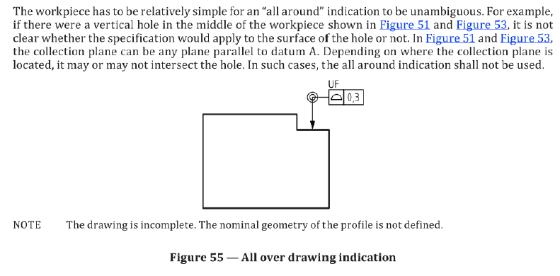

I came across another use of UF that confuses me a bit.
As stated in para. 3.9 in ISO 1101:2017 Note 2:
"However, it is not intended that a united feature can be used to define something that is by nature several separate features."
Then I see in para. 9.1.2 That UF is used with the "all over" symbol that unites multiple features. Isn't this contrary to the statement in 3.9?
From ISO 1101:
AlexFH said:
....Then I see in para. 9.1.2 That UF is used with the "all over" symbol that unites multiple features. Isn't this contrary to the statement in 3.9?...
Per UF definition: compound integral feature which may or may not be continuous, considered as a single feature.
I would argue that the figure 55 is a single feature and since "all over"--double circles-- (not "all around") symbol is used that makes the entire part a "single feature" so UF would be the appropriate symbol to be used.
And of course, it is correct, because the standard says so :)

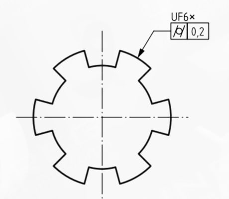

Then I would say that the INTENT of UF was not to be applied for those "regular" features of size. That is reserved for CT which is called common toleranced feature of size.
I guess you can use UF to be creative...but again that is my opinion.
(since you already have CT, I might not see why would you want to use UF, but anyway)
Ok, thank you,
But then, why did they use UF and not the "common toleranced feature of size" modifier, CT, on this one?
The example is from ISO 1101:2017. Looks like an end view of a simple spline shaft, it should be considered a feature of size.
