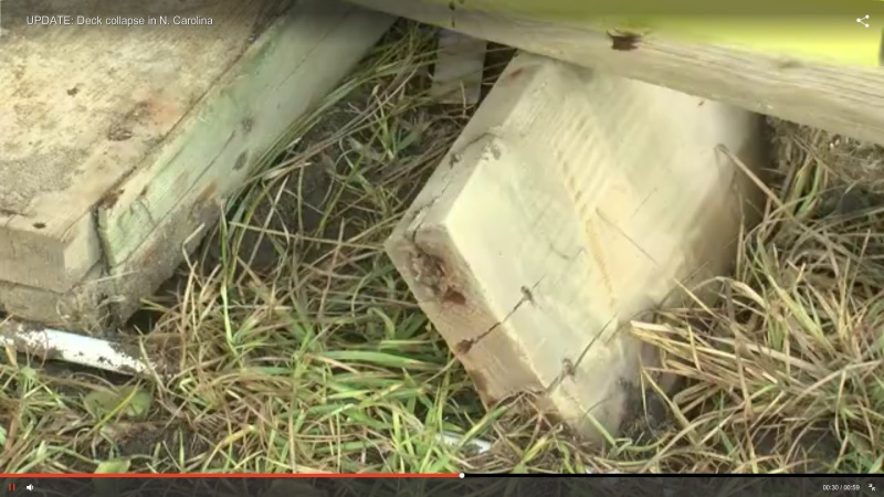

Here's a close up of a joist end - taken from this video: Video Link - go to the 30 second mark
With nails sticking out up above - it seems like the bond between the nail and joist was such that many simply pulled out of the end grain.
This may not be the initial cause of the collapse - perhaps something gave way in shear and that started a domino effect as the deck joists pulled away from the supporting beam.

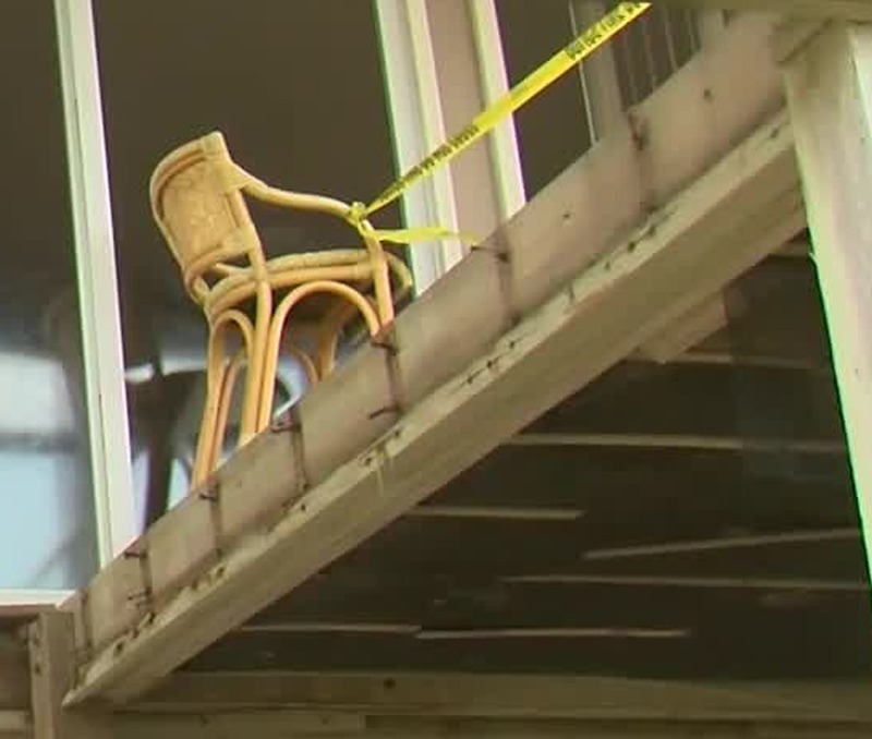

The ledgers seem to have stayed attached. Maybe they were fixed with different fasteners.
The edge beam rolled when loaded, and there were no nails left to resist.

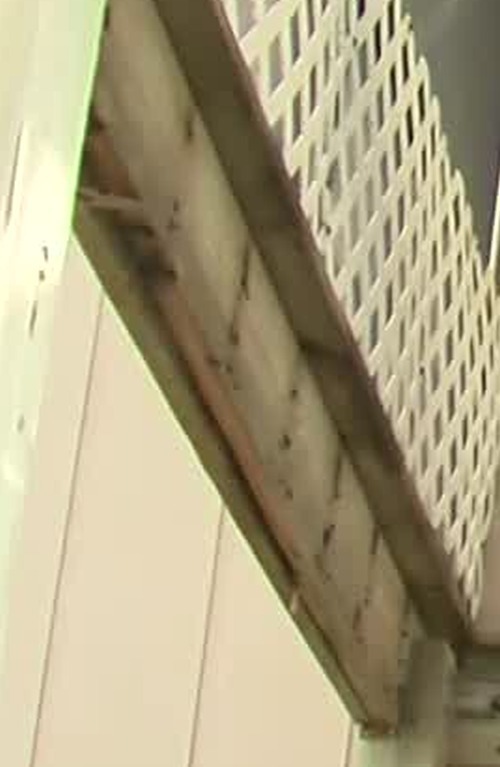

Hokie - I believe the left ledger is gone. Take a look at the enlargement of IRstuff's photo below.
I propose all the corroded nail on the left side sheared (the nails into the ends of the joist and the nails holding the ledger in place).
As the left side of the floor descended the joists rotated downward... pulling away from nails remaining in place on the right.
This explains why no full length nails are visible on the left side, yet the right ledger and full length nails are visible on the right.
The photo JAE furnished, showing nail holes, must be of the right end of the joists.
Here is the enlargement of the left side:

The connections at the end of the joist shows as two side toenails and one top toenail. Proof not to rely on toenails.

Looks like the left ledger dropped and allowed rotation that pulled the right side of the joists out from the beam.
The ledgers were installed on the bottom of a double beam, with all the fasteners in tension (however few of them there were). Ledger fasteners should be in shear, not tension. Even if the fasteners did not corrode, it would be easier to overload the pullout in this orientation.
I didn't get that, Ron. Looks like to me the ledgers were about 2"x2", nailed to the side of the beams. The one on the right side which was still in place seemed to have nails horizontal.

SRE...that's what I would have expected as well except that the right side looks like a solid piece of lumber under the double 2x10's. I see the 3 nails under each joist, as you would expect, but it looks strange. Maybe I'm just not seeing it correctly from the angle or resolution.
I think you'd have to be nuts to construct it as I described above, but considering the amount of bad construction I've investigated over the last 35 years, not much surprises me anymore.
Looking at the band below the sliding glass doors, the left side looks like maybe a 2x12 and the right side narrower and is pieced with a 2x2. Why? That member picks up essentially no load.
Ron, I think it is a visual illusion - the 2x2 shadow is farther down the wall, indicating it is protruding farther from the wall than the 2x12. There seems like some anti-pest netting underneath and maybe the little strip was part of that.
