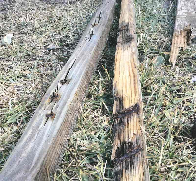

Another wood structure collapse. This one has clean drop at joist buckets. Hmmmm.....fastening issue perhaps?
News story notes it as a "balcony collapse"; however, it is an elevated deck.
Deck Collapse
A photo is attached as well.
 http://files.engineering.com/getfile.aspx?folder=5d480a3a-9221-40b0-a3a0-f3c5ac26d4b0&file=DeckCollapse-NC.pdf
The ledger looks like a 2x8 laid flat against the bottom of the beam. It looks like the ledger is toenailed to the beam since no fasteners are visible in the bottom face of the ledger.
Considering the first picture posted and slider less comment about the left rim...
1. Where is the left rim in the first picture? Had it already been removed or lost?
2. I wondering if the lower corner was hit looking at the vertical misalignment of the top to bottom columns. May have been constructed that way though.
3. If the section just dropped vertically, why is the handrail damaged?
Something else happened.

The Town of Emerald Isle has issued their final report. Most of it concerns the first responders performance. There is a letter
from the County Building Codes Administrator that has his investigation results:
Double 2 x 10 Beams, 10' Long​
2 x 8 Joists @ 16" o.c., 8' 6" Long​
2 x 2 Ledgers Nailed to the 2 x 10 Beams​
"Collapse is a Result of corroded fasteners"​
The complete report is attached below (.pdf, 19 pages, 8.8 MB)

The Building Codes Administrator reported that the nails appeared to be galvanized. Would this typically indicate hot dipped galvanized, or could it mean electro-galvanized nails?
I vacation at the beach in NC once a year. A couple years ago a deck collapsed at Ocean Isle beach (not far from this one). The environment out there is harsh. You should see people's outside air handlers. They, and really everything that is outside gets corroded quickly. I remember that the zipper on a bocce ball set that was stored inside, albeit not in a conditioned space was corroded. I don't know the solution for this type of environment other than providing a mechanism of failure that is visually evident prior to failure. I think Simpson hanger connections (top flange ones) would be a better solution. Maybe even coat the fastener's with a better coating than the hanger. That way when you see the hanger corroding you know it's time to do something. Because you won't see the fasteners fail, but you might see excessive corrosion on a hanger.

Looking at the pictures I don't see how anyone can determine what was galv was used (if any). In the 1980s Hot dip Galv was not always used on coastal decks.
Loading 24-26 people on the 1/3 western corner of a 8'6x10' deck overloads the structure (I believe the SBC used 40 PSF in the 1980s)
Isn't that black stain in the wood at the fasteners caused by leaching/oxidation of the zinc coating?
Charlie, looked like they were rusted away in the ledger
