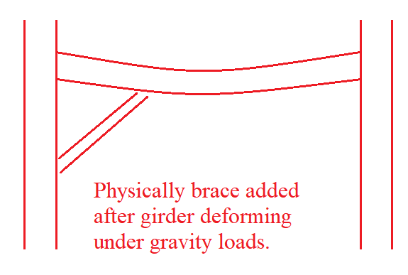

Dear Engineers,
I have attached a figure herewith which will be beneficial in understanding my query.
As you can see, the steel building is three-storied, and some knee braces were added previously to avoid retrofitting of some main steel beams (girders). The purpose was to reduce the length of the member and produce less loads in the girder, which was achieved well.
However, the knee braces' connections are not capable to resist the loads transferred to them in ETABS.
Two bolts can carry about 24.8 kips of shear load.
Whereas in FEM (ETABS) we get a force of about 45 kips due to gravity load combos. Also in some gravity+lateral load combos, the applied load exceeds the capacity of the connection.
Is there any method by which we can declare that these knee braces are provided just to carry say 20 kips forces and the latter forces are not intended for it, equilibrium will be established for the whole structure considering this trade-off (knee braces taking only 20 kips).
Is this justifiable??
This is an existing building, we don't want to apply weld and ignore those bolts to carry the applied loads, because it will be massive work and the factory is in operation.
Thanks....

I think I would check buckling and other stuffs and find stiffness of the connection and assign it in the model to attract loads suitably.
From this obtained load, i would deduct the dead load, on LL apply LLRF and finally calculate the load and check against connection capacity.

What is the moment in the beam with and without the brace?
Have you found the deflection of the beam without the brace at the location of the brace?
What happens if one side of the column is experiencing full live loads and the other is not?

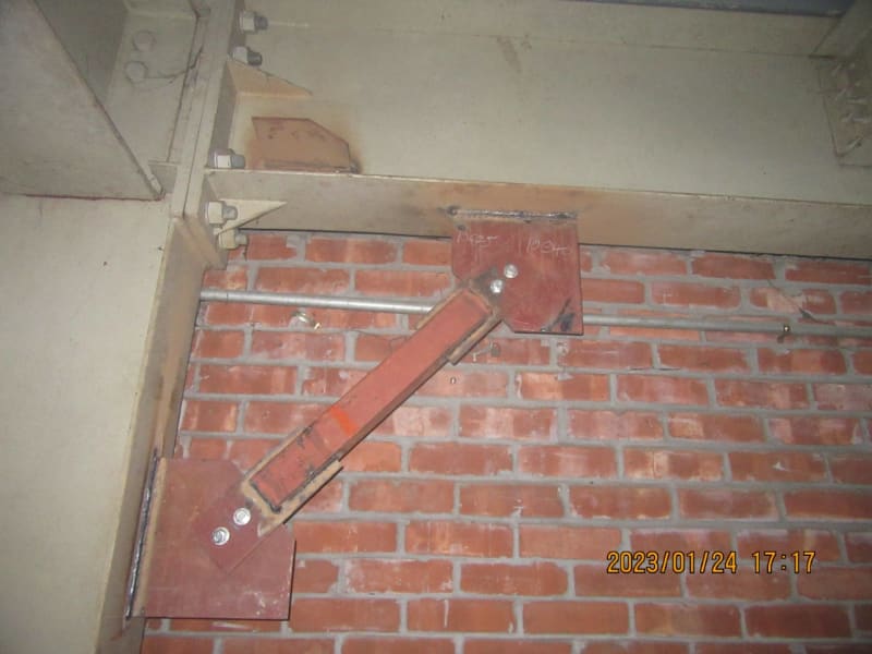

It looks like in the photo that you could weld the plate to the gusset, thereby no longer requiring the bolts. Is there a reason welds can't be added to remove the bolts being the failure mechanism?
Do you know what the original design intention was?

Moment is additive. So;
if you calculate the moment in the beam due to dead weight before the brace(assuming the brace was installed with no live load),
and then calculated the moment in the beam and due to imposed loads etc in the presences of the brace,
and then add them together and including relevant factors then you'll be getting somewhere
If this moment does not exceed the capacity well you might just be OK.
Unless I'm mistaken, the knee brace member here is flat strap. Granted, I do have pretty serious presbyopia these days. If that's correct, then I would offer the following, dissenting opinion:
1) No way in hell these were ever installed with the intent of assisting the girders.
2) I highly suspect that the knee braces were intended to serve as tension only, lateral load resisting elements.
3) Ideally, the flat strap would buckle out of the way before the overloading the bolts in compression (gravity or lateral induced).
To the extent that I'm correct about this, you may well be able to cap the amount of force received by the bolts well below that which would be predicted by your ETABS model.
Koot, I'm pretty sure those are square HSS with a knife plate.
This is an imperfect analog but, conceptually, tension only knee bracing is a bit like Flexible Moment Connections which are also intended to meaningfully engage only under the action of lateral loads: Link.
Frankly, I detest both knee braces and FMC and try mightily hard to avoid both in the context of new builds. But, alas, I'm not the boss of the world so this stuff must be accommodated sometimes. I table this simply to point out that there is precedent for such things.
Clearly, the bolts have not been overloaded by beam shear yet. That's something, particularly given that prying action from the girder would develop monstrous forces in an unbuckled brace in a wicked hurry.
There's definitely some thickness there. I'd considered either:
1) Two straps with a spacer to facilitate symmetry.
2) A rather narrow HSS.
Either way, the same thing may apply. Granted, even a narrow HSS will have significant axial capacity over such a short length.
Additional observations:
1) The girder to column connection here is obviously a moment connection of some stiffness. So point is a location of minimal beam slope. That, as opposed to it being a point of maximal beam slope as would be the case for a simply supported beam.
2) The brace only absorbs connection in proportion to how much point [A] moves downward. Given the scale of the girder, and the presence of the moment connection, I'm guess that deformation is pretty small.
3) Given the scale of the girder to column moment connection, it's hard to imagine that the braces would do anything meaningful for lateral loads, even if they were adequately designed for the anticipated compression.
4) The brace gussets are horribly eccentric. My money would be on them rolling over long before the brace was fully mobilized for anything usefull in compression.
SUMMARY: I'd be treating this connection as though the brace wasn't even there.
