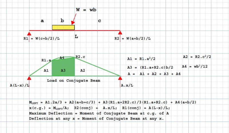

Here is a case of a partial uniform load on a beam. It would be good for a spread sheet I think, and you could use a separate line for each different kind of load. Two or three lines should be enough for most beams, but there is no limit. In the end, the spread sheet would sum the values at each station, showing a composite deflection diagram.
I substituted some values and my results are shown below. Have not checked to see if they are reasonable. Will do so in due course.

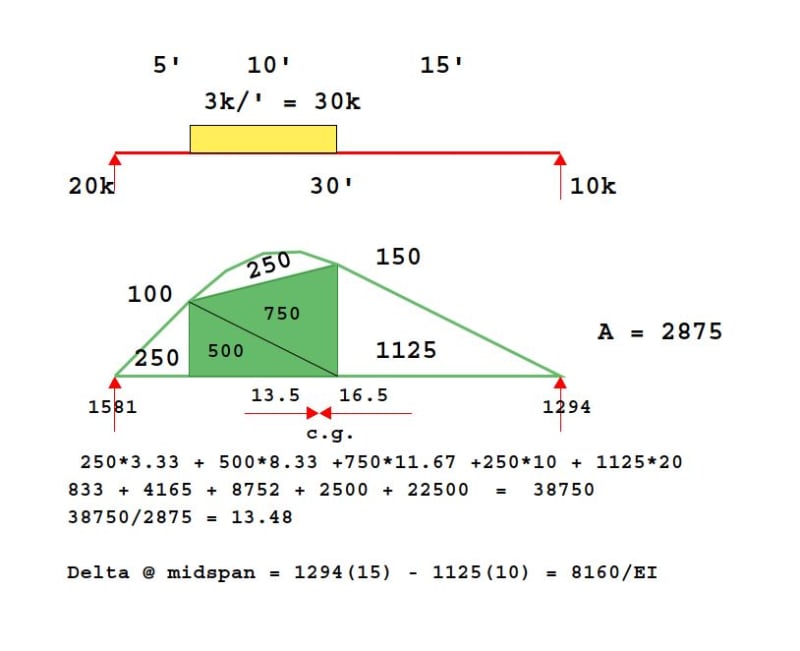

For a 30' span with a point load of 30k centred 10' from one end, the moment would be Pab/L = 30*10*20/30 = 200'k. Deflection at point of load would be Pa[sup]2[/sup]b[sup]2[/sup]/3EIl, or 30*(10*20)[sup]2[/sup]/3EI*30= 13,333/EI, considerably more than my result 8160/EI but looks believable.
The method needs more testing, but the OP should be optimistic about using a spreadsheet.

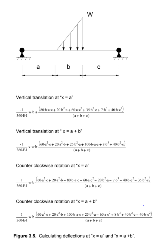

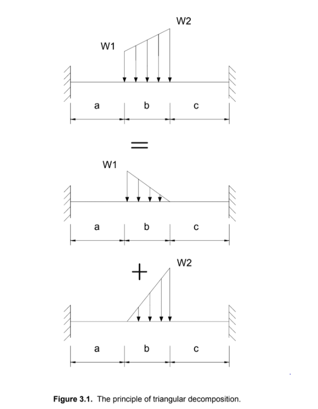

1) I believe that I solved this problem back in 1999 in the course of developing some software. The key to my method is to recognize that any possible uniformly varying load can be treated as the superposition of two triangular loads. For the triangular cases, I used shape functions and integration to get the job done (with MathCAD's help).
2) I would not blame you for doubting the accuracy of these equations. That said, I vetted the crap out of them and actually found bug in S-Frame in the process of doing so. I've also been using these equations for about 20 years in some MathCAD design sheets without incident.
3) Realistically, the hardest part of getting this right is typing out the equations properly.
4) The closed form solutions run wicked fast in MathCAD relative to iterative or discretized approaches which is helpful there.

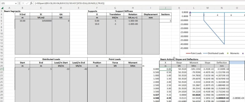

I ran it in my ConBeamU spreadsheet (using the single span function) and got exactly the same results (to displayed precision).
Using the spreadsheet, if it is important to get the position of maximum deflection and/or bending moment the Excel solver does a good job of finding that. For the deflections I multiplied the deflection by 1E6 in the adjacent column, to save adjusting the solver tolerance, or I could have just set the deflection units to nanometres.
I also checked baretired's example and got significantly different results, but I will double-check the units on that one before posting the results.

I just checked the Stress-eng example in my FEA software with the beam divided into 10 segments. The magnitude and location of the maximum bending moment agreed exactly, and this is reported in the standard output. The location of the maximum deflection was reported as 4.60 m (compared with 4.588 m) and the magnitude only agreed to 5 significant figures :)
Deflections are found by fitting a cubic shape function to the deflections calculated at beam ends, so it is not surprising that there are small differences compared with our calculations, where we adjusted the beam end locations to find the "exact" maximum deflections.
Note that all these calculations are ignoring shear deflections, which would have a far bigger effect than the 6th significant figure.
BA - I'll post my results later. They were the same order of magnitude as yours :)
