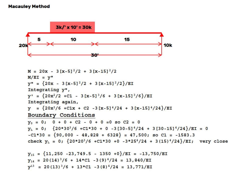

Hey all,
Anyone know of a resource to find a ton of different deflection equations? Everything I can find for a UDL not across the whole beam (and not located starting at a support) only gives the moment equation and no deflection.
Or if you know of a good resource where they go over the derivation of the deflection equations. For weird cases I typically use clearcalcs or RISA 2D for quick results, but it would be nice to have a spreadsheet that uses the superimpose method.

Something is wrong Doug. My last line should read: Delta @ midspan = 1294(15) - 1125(5) = 13,785/EI, not 8160/EI.
I agree with your maximum moments of 167'k and 200'k for the distributed and point load cases respectively, but the deflections can't be right, particularly if they are in feet.
For a maximum moment of 200'k, we could try W18x50 with I of 802in^4. EI=29,000k/in^2*802in^4 = 23.258e6 k-in^2 or 161,514 k-ft^2. Then delta = 13785/161,514 = 0.08535' = 1.02", very nearly L/360, which sounds a little more reasonable.

I set the EI to 8160 so the deflection would be 1 foot. Changing to 13,785 I get:
- At mid-span 0.997 ft
= At 13.923 ft (max. deflection point): 1.004 ft.
So that's pretty good :)
Using your realistic EI value I get a maximum deflection of 1.028 in.

The same patch loading solved earlier using Conjugate Beam is solved below using the Macauley Method. It looks like a good way to find deflection when there are many different load types and it should be ideal for a spreadsheet.
The location of maximum deflection could have been solved by setting y' equal to zero, but it would require solving a cubic equation, so deflections were found at three locations. Maximum deflection is seen to be located between 13' and 15' from the left end.
