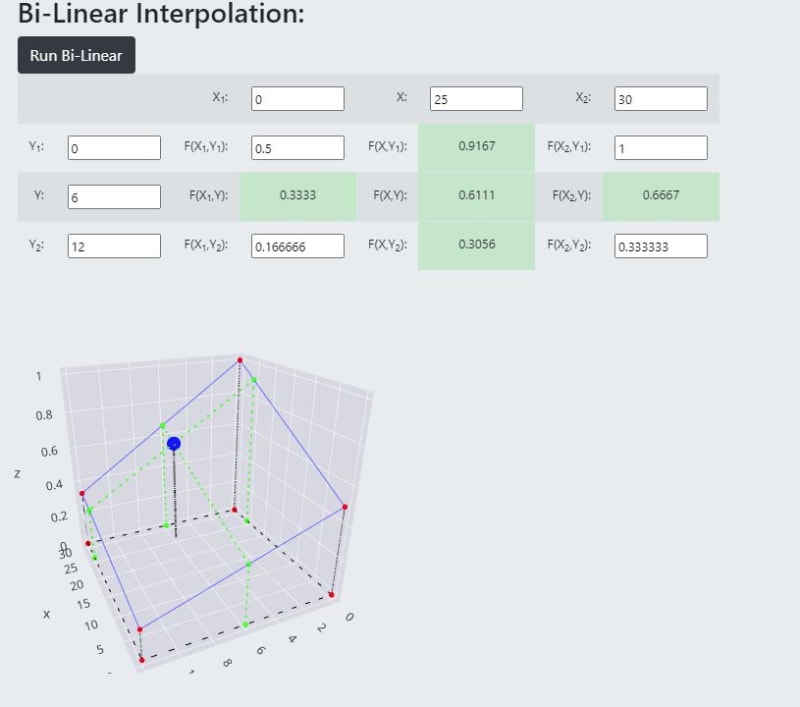

I disagree with your approach, your approaching this by trying to generate deflection functions based on the foundation stiffness/flexibility with a soil reaction that was determined based on the assumption that the foundation is rigid, they are fundamentally inconsistent. Additionally the bearing pressure is a function of the settlement/deflection into the soil mass computing a different settlement/deflection than generated by the assumed rigid body motion invalidates the pressure.
The calculations need to honor the original analysis assumptions, an example for a rigid base assumption under some fictitious bi-axial load condition:
Celt,
I tried not to wade into the biaxial portion of it and agree that the method I was suggesting is less than ideal, however, it does address the question from the OP.
I think you`re correct to point out that this argument is a little bit circular: "deflection functions based on the foundation stiffness/flexibility with a soil reaction that was determined based on the assumption that the foundation is rigid, they are fundamentally inconsistent" but I disagree that they`re substantially inconsistent, if the foundation is thick enough that the rigid assumption was reasonable and the calculated deflections were small.
In keeping with the original post, how would you approach the question, with only pencil and paper?
Your method seems to be predicting soil settlement at 4 corners (step 4 of my process) without making any consideration of concrete deformation.

The fundamental assumption of the bearing pressure analysis is the foundation is rigid, no deformation of the concrete.
The soil pressure is a direct response to the deformation of the rigid body foundation into the soil mass, the only deformation that produces that specific bearing pressure profile is the rigid body movement into the soil mass. There is no additional deformation as any additional deformation would alter the bearing pressure.

Last thing is that you assumed that 𝛅c = 1", which calculation required to get this value?
You need to discuss the settlement with the geotechnical engineer.
Please understand that if settlement/deformation is a design consideration then the rigid analysis is not appropriate and you should do a finite element analysis coordinating the spring value to be used and resulting settlement results with the geotechnical engineer.
