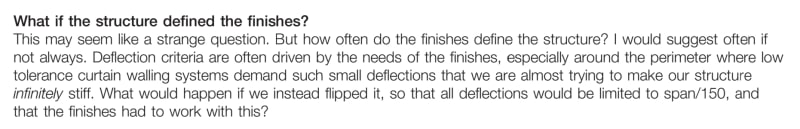

When a relative long spanning beam is close to a stationary wall, I considered the deflection of the beam relative to the wall. If the finishes require it, I use The span perpendicular to the beam in question to figure the allowable deflection.
Infinite stiffness to suit brittle cladding. Point owners to Ron's comment here to explain why they must pay through the nose for choosing brittle finishes.
