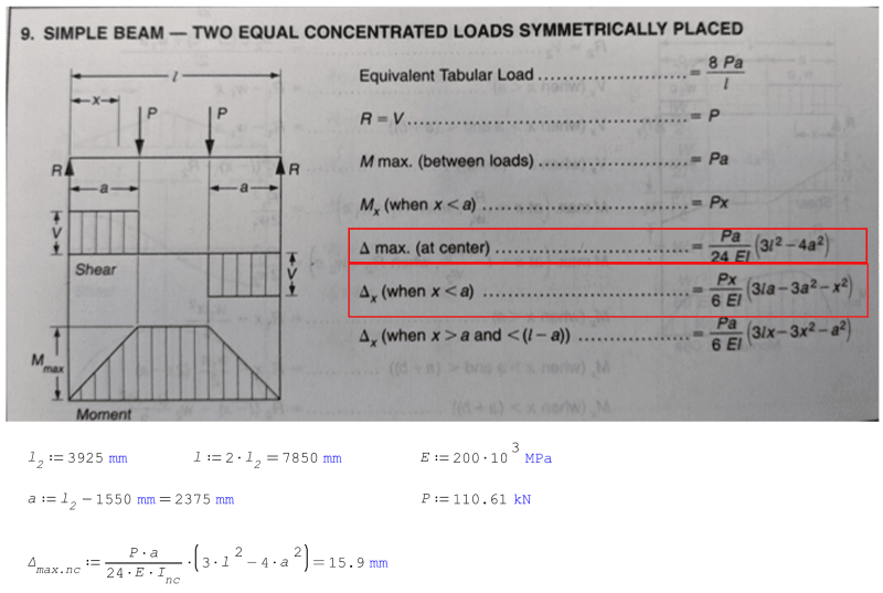

I know that:
- The deflections are equal (Δ1 = Δ2).
- The equation of the deflection if there was one beam would be:
Δx = (P*x*(3*L*a-3*a^2-x^2))/(6*E*I)
Since we are looking for the deflection at x = a, then:
Δa = (P*a*(3*L*a-4*a^2))/(6*E*I)

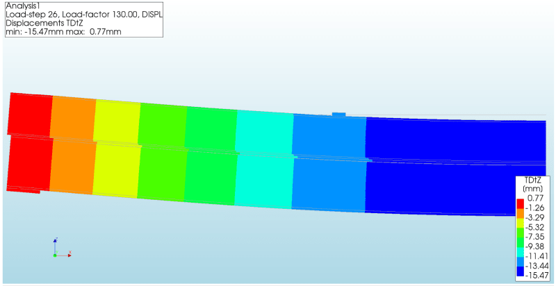

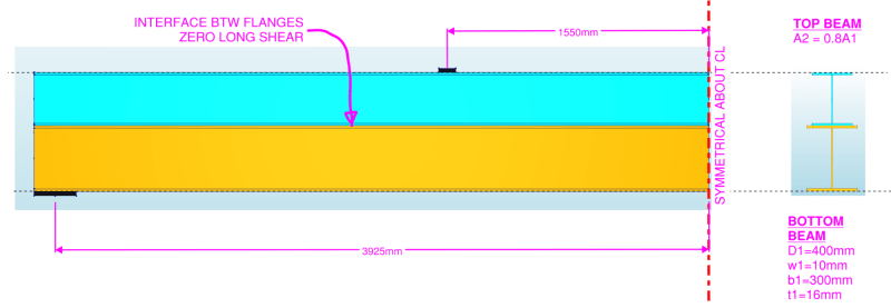

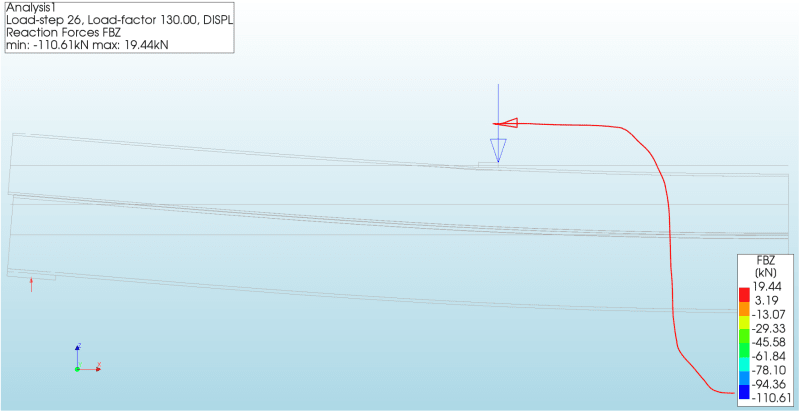

Picture time. Needed a break from real work, so I created a model of this. This has a fictitious interface between the flanges that permits zero longitudinal shear. This model does not include any load distortion effects.
I found the sum of I1+I2 compares well to the model. It will not be exact due to the width of the loaded shape.

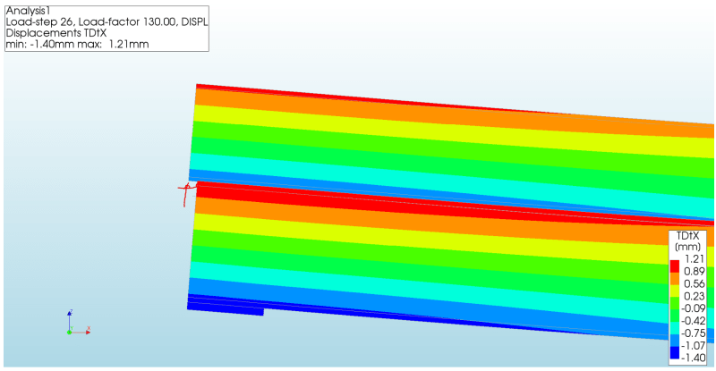

I think Pham's note about the assumption can be seen well in the image below. For the assumption of zero longitudinal shear to be true, you would need around 3mm of lateral displacement between the two profiles at the end in this example.
Brad805 - curious how you got the FEA to run with the unconstrained upper beam.
I'm surprised this isn't completed, yet. Calculate the deflection based on I1+I2 as noted above. Then proportion the load based on the relative deflections. In this manner the deflection of the two beams are the same with the appropriate portion of the total load. This assumes there is no friction interference at the interface... greased beams? [ponder]
dvd, this software has interfaces. I used an interface between the two beams where the XX is released. Both the YY and ZZ values are perfectly restrained. Not physically possible, I know. At the middle of the beam I have an XX restraint to both beams since it was assumed the beam assembly is symmetrical.
dik, I was curious if I could replicate this in a model.
