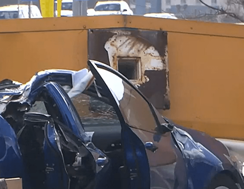

You do wonder though if that mid point sign which is at 90 degrees to the main sign but lower down affected the frequency of any vibrations. No other really tall sign in that area seems to have one. They have been there since at least 2008 though - earliest street view image. GE images are not clear but it doesn't look like it was there in 2004.

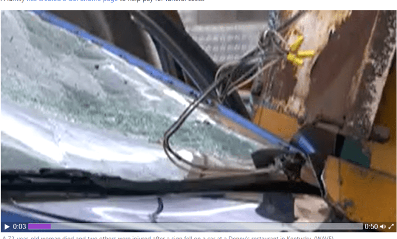

But four relatively weedy looking bolts to hold that size sign looks very non redundant. The little snap of a security video in one of those news reports seems to show a pretty sudden failure with no real wobbling beforehand. It just fell off.
Quite odd really that more haven't fallen down.
But we're running here with no drawings, no decent pictures or any installation documentation. So running blind. We don't even know if the sign was bolted on first and then the pole jacked up or the whole thing laid on the ground and lifted up in one lift or ???

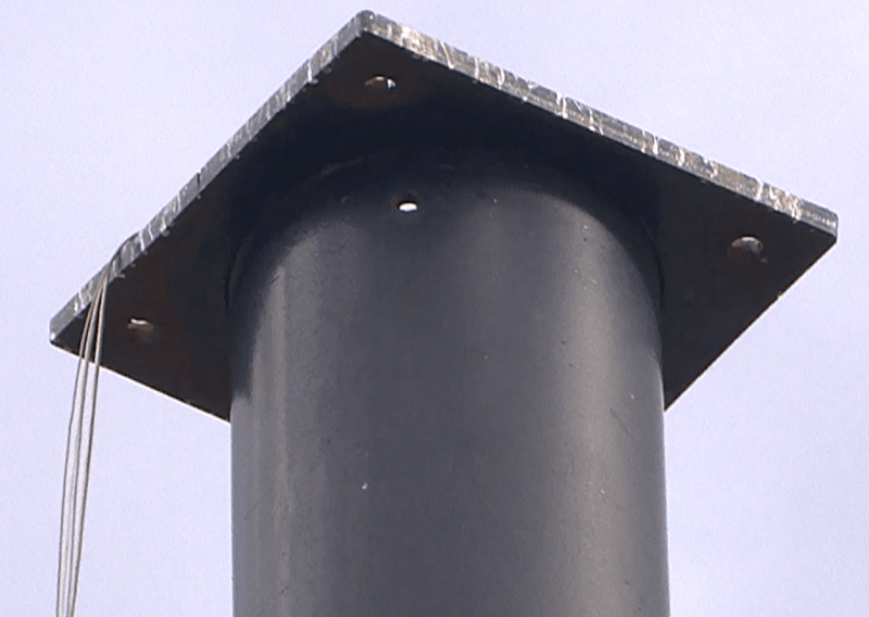

The hole sizes in the top plate of the pole which is shown do look rather different than on the sign. And no sign of any distress on the bottom of the bolt holes.
So a bit like spalso said - wrong size bolts. It's far from unfeasible that they just added or used a set of oversize washers which essentially made the washer the structural element. Or the holes were deliberately bigger to allow for any misalignment.
It's been seen on pipe flanges which is one reason some oil companies banned the use of washers on flanged joints after someone did the same thing and eventually the washer failed and the nut just pulled through the hole.
I don't have a lot of faith anyone will ever find out though. - "An investigation is ongoing by the Elizabethtown Police Department as well as the City of Elizabethtown’s Planning Department.".
A couple more closeups. Still not great photos but it does kindof look like the bolt heads (bolts seem to have been installed with the bolt head below and the double nuts and a washer on top) slowly broached their way through the holes in the plate on the pole. I think I can barely make out that there are 3 bolts still remaining in the plate on the sign (pics 2 and 3). It doesn't look like there was a washer between the bolt head and the bottom of the pole top plate (pic 2). It looks like the pole plate is maybe 3/4" thick? Sign plate is way thicker for some reason, maybe 1-1/2" to 2"? It could be that the actual sign "cabinet" is a "off the shelf, worst-case wind speed" item that was designed once, but I'm sure the pole was actually engineered for the site . Also, the HSS member going from the sign plate into the cabinet looks beefy as all hell too. Furthering the "design it once" theory for the cabinet. Maybe the cabinet manufacturer "designed" the plate and HSS using the "I have no idea what I'm doing but when in doubt, make it stout" method. And clearly had no clue about edge distances. I'm positive that the actual foundation and pole would be required to have stamped design/drawings for every site, but now I'm curious about if the cabinet itself would be considered part of the 'structure' or more of 'equipment' that just gets mounted to the top (in the eyes of the jurisdictions).
I suppose over time the cyclic loading (100's of cycles per day? More?) just let the bolt head chew/broach its way through the pole plate. Surely the bolts were installed tight but over time 'something' happened and they loosened or stretched which allowed the sign to start 'wobbling' and initiate the broaching. I'd assume the plates would be A36 steel. The edge distance on the sign plate is obviously way too slim (can't be much more than 3/8" of material left between the hole and the edge) but it doesn't seem like that was a factor in the broaching of the lower plate.
