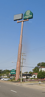

We have very few signs that are so high as those common in the USA; I don't want to say "none" but I can't think of any in my area (near Toronto). In the USA there's a forest of signs like this at practically every motorway junction, and non-stop billboards (which we also have fewer of). I suspect there's a permit process that puts limits on this ...
typical around here (note the McD's sign):
closer view of that one
