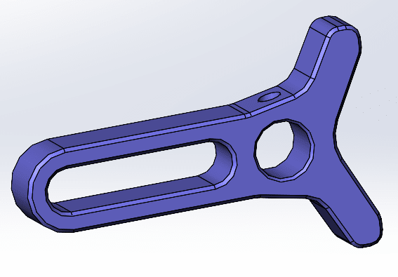

On a separate note, we have a pin reciprocating in a slot. I've attached an image of the slotted rocker here. In a previous arrangement, we observed a lot of wear in the slot. We are now considering two options:
1. Using an SS304 slotted rocker and nitride it to 50 HRC. The dia 3mm pin would be a hardened (HRC50) SS416 dowel pin
2. Hardening an SS416 slotted rocker to HRC50. The dia 3mm pin would be a hardened (HRC50) SS416 dowel pin
Forces normal to the slot are in the order of 40-50 N max.
My questions are as follows:
1. Should the pin be harder than the slotted rocker or vice versa? I think the pin will get worn faster and should be harder. Is my understanding correct?
2. We have material constraints and have to remain within stainless steels. What options would you people suggest to minimize wear (including or other than the 2 listed above)?
Any leads would be appreciated.
Thanks!

Wear is a minefield in terms of variables however I would suggest that you make the easiest part to replace the one that wears
IMHO, if the slot is wearing faster than pin then you need to make slot and pin both of material which is good wear resistant (400 series). Besides the pin diameter of 3mm seems too low for any long duration friction. It will get consumed fast. Main tread off between 300 and 400 series is the corrosion resistance.

This makes sense. We're using off-the-shelf dowel pins and those would be easiest to replace. Thanks!
NRP99 said:
Corrosion is not a really big concern since these parts should never really get in contact with water. These are meant to be safeguarded against corrosion under general ambient humidity.
I guess that SS416 would better suit our hardness requirement.
Thanks!
Is that part in the picture the one that connects to your D shaft?
From what I see, that thing could be modified to form a clamp which would be far better for transmitting torque than a set screw.

For the rocker there are a few choices.
I would go with hard pins, 410, 420, or even 17-4PH should be available. You could even use 440 If you can get them easily.
The rocker does need to be harder than standard 304. While nitride is one option the soft core material doesn't support the hard surface very well.
You could look at 301LN or Nitronic 40 (another 200 grade). They will work harden a lot under wear and are very resistant to galling.
If you go with a 400 grade make the rocker HRC 45-50 and keep the pin about 5 points lower.
Using different materials always helps reduce galling and can help wear as well.
EdStainless, do you mean that we keep the pin slightly less harder than the rocker? Doesn't this conflict with your first statement that the rocker need not be harder than SS304?
