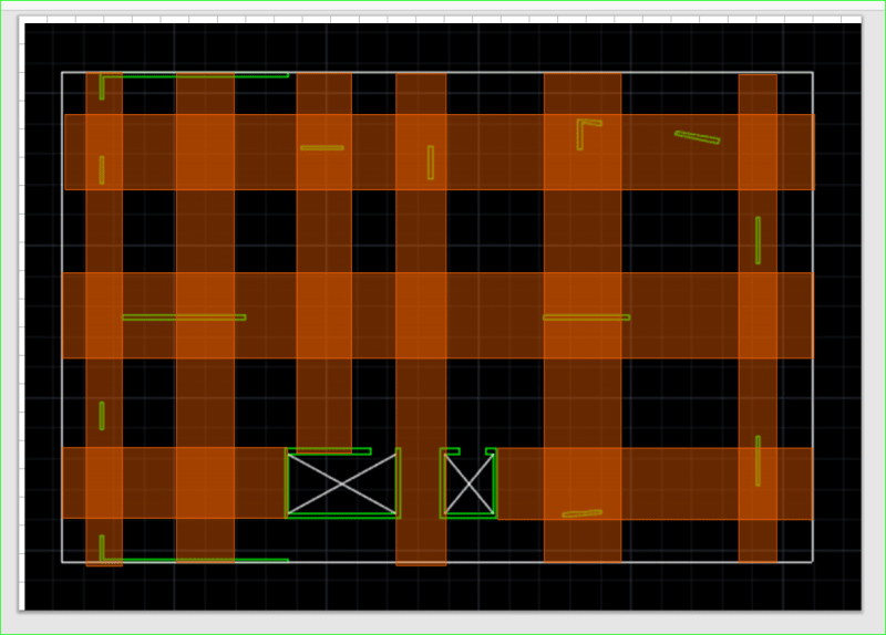

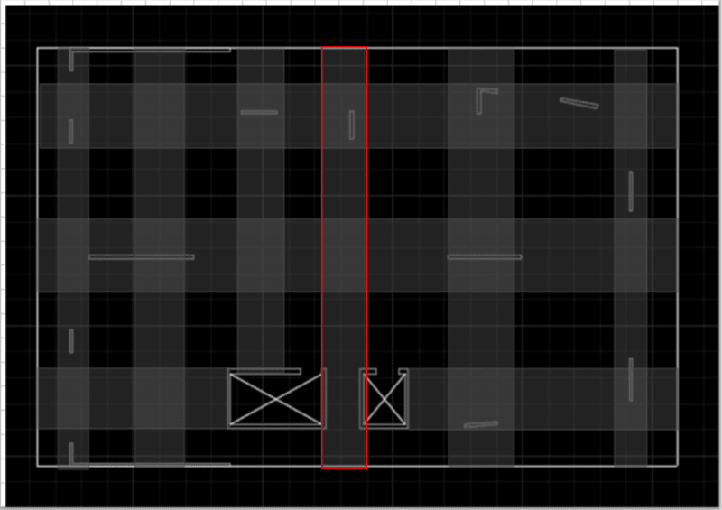

I have a flat slab with irregular supports. I want the reinforcement to follow the global x & y direction instead of principal moment direction.
So I am thinking having design strips passing each support but I find it very hard to arrange the design strips. Can anyone share your thoughts or if you can, provide your design strips say latitude for this one?
As these short walls have two ends, do I run two design strips through both ends? Can anyone please share some example of this kind of structure?
Thank you.

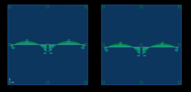

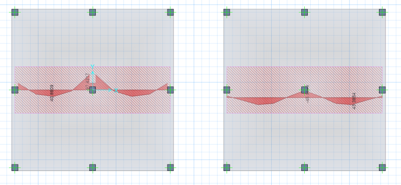

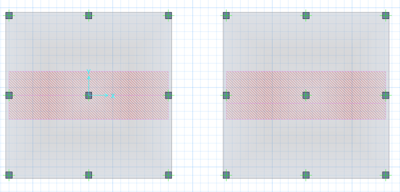

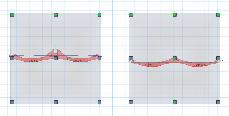

I have done a quick comparison in SAFE as below. Both of the strip are 3 meters wide. The only difference between them the RHS strip is central placed with 1.5meters width on both right and left sides with span while the the 'span segment' of the RHS strip is shifted 0.5meters lower and change the geometry to be 2 meters on right and 1 meters on left. By doing this, the RHS strip span segment will pass supports while the LHS one will not. But their widths are the same and the strips are cover the same area, meaning the analysis will be exactly the same.
So I can check how the design strip average out the peak moments and get the mean values of the design strip. And below is the strip force and the design results that I get. Apparently the design strips are not doing the same job - meaning they don't average out the values of the cross sections, otherwise the results will be the same. Rather, it works like I said, pick up the values along the segments only and divide by the width?. Am I correct or do I miss anything here.

no the backend solution is a stiffness matrix for all of the nodes of the mesh, the solution to the fundamental equation F=k*d will yield deformation and force results at all of the nodes. The strip then defines the zone over which the results will be summed, area under the curve.

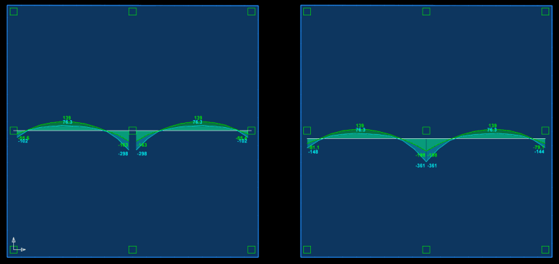

I would have expected your shifted strip to actually yield a higher design moment at the center column as the design would no longer be truncated to the face of the column.
Another thing worth looking into in their manual is how it lays out design sections along a design strip. It could be in your shifted strip the first design section cuts are further away from the column. Unlike a beam/frame program locations of absolute max/min moments and shear aren’t found automatically, instead the program usually relies on cutting design sections on a regular interval.

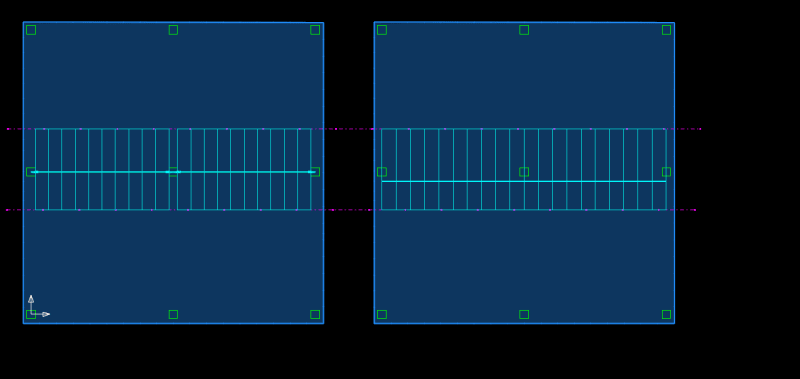

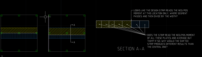

Thanks Celt83. Yes. I understand that is how it works at analysis stage. But does this have to do with the strips? I would expect the FEA is run, get the results, and the only thing strips do is to read these results and average out them. ie. Strip will not affect the analysis, they just get the results from the analysis.
If so, why would the design results differ from central stirp to shifted one? I have uploaded the pic as below to further illustrate my confusion.

So in your section A-A it should be reading the negative and positive moment across all of the plates and doing an envelope of summation, note there should be no averaging per se it should be more direct summation, the program I'm familiar with does the summation (really integration) using only the nodal results because the stress results across the element can have localized concentrations. Also it can't be dividing by the width as that wouldn't produce compatible units, moment is units of force*distance if you then divide by distance you'd be left with units of force. The FEM results for a singular line would also be fairly small by comparison.
I'm not overly familiar with SAFE so you will need to review their manual on how it does the enveloping where there are changes of sign across the design segment.
There are really two components there is the design strip and then also a design segment. The design strip defines the effective width, theta angle for your moment and bar orientation. A design segment is your A-A section which will usually occur at each end of a design strip and at some regular interval along the strip.

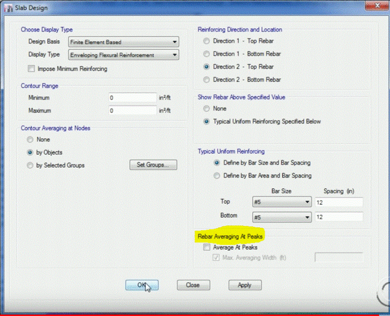

SAFE offer this option too but I don't think FEM based can be used for design directly. The peak moments over support have to be average out.
FEM can be used directly for the design. If you want to average the peak moments over the support just select that option and select an averaging width.

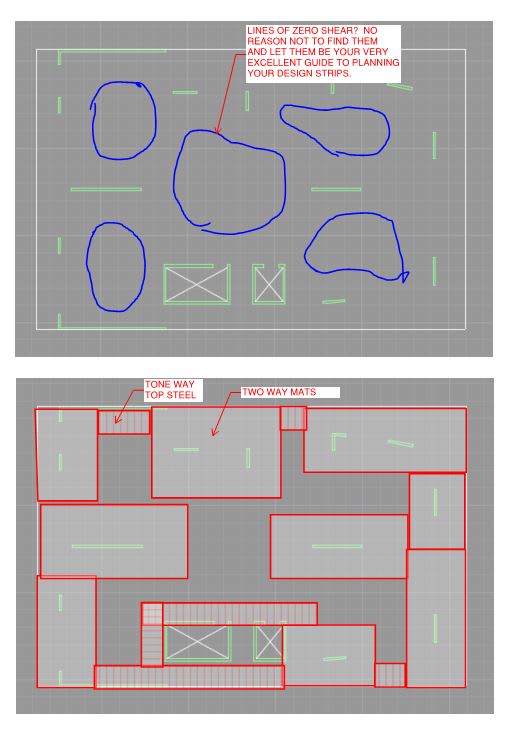

For a highly irregular layout like this, I feel that this excellent suggestion has gone under the radar here for much too long:
Trenno said:
As a first step, do some reading on the "method of zero shear" Example Info
The zero shear method is a truly excellent tool for this kind of thing. With FEM, I can't think of any reason why one wouldn't make use of that.
For me, I'm stepping through things like this:
1) Plot the shear contours and locate the lines of zero shear.
2) Ballpark my expectations for top mats using #1, the thing mounted above my shoulders, and assuming some walking lanes for construction personnel.
3) Move into strips and reinforcing having been well informed by #1 & #2.
If somebody steps up with the zero shear diagram, I'll do the same with some strip recommendations.
Also useful to have your orthogonal plot zero shear diagrams as well.

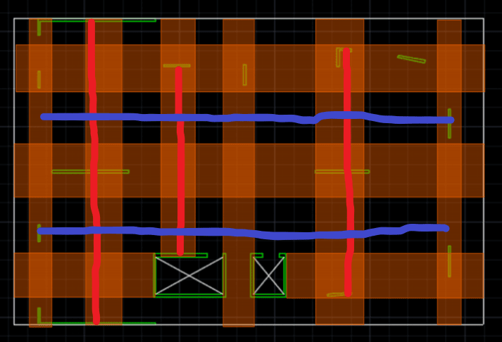

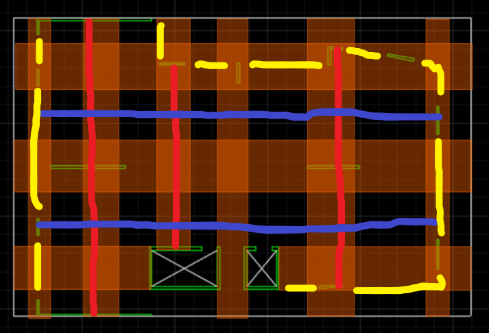

IMO, your primary reinforcement is running N-S, the strips are represented by the red lines. The blue lines represent secondary reinforcement that will be affected by the rigidity of the primary reinforcement. The remaining area can be reinforced by engineering judgement and detailing.
Add a few torsional element/edge beam (yellow).
