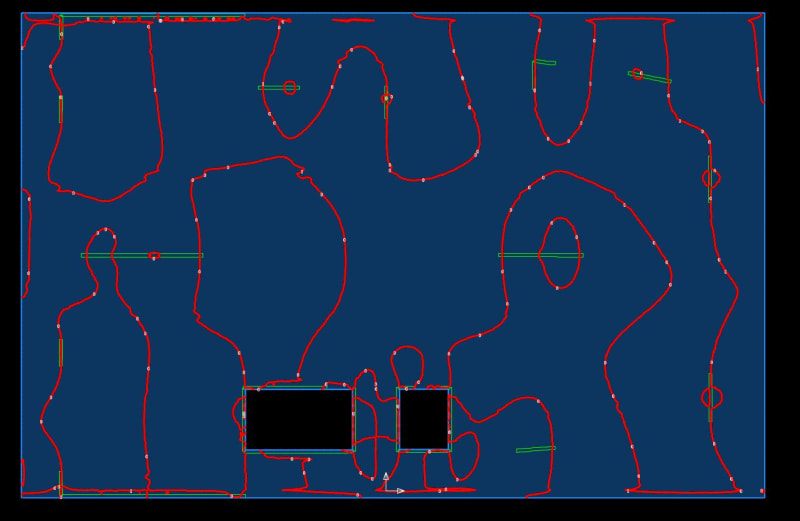

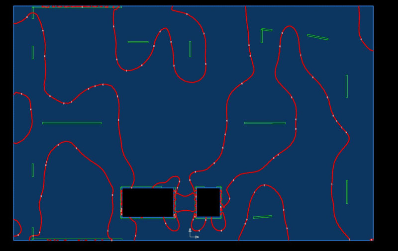

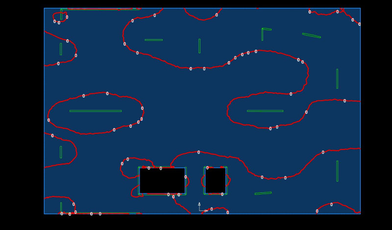

I have a flat slab with irregular supports. I want the reinforcement to follow the global x & y direction instead of principal moment direction.
So I am thinking having design strips passing each support but I find it very hard to arrange the design strips. Can anyone share your thoughts or if you can, provide your design strips say latitude for this one?
As these short walls have two ends, do I run two design strips through both ends? Can anyone please share some example of this kind of structure?
Thank you.

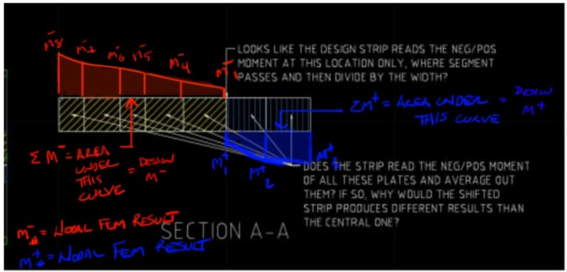

Going back to your section A-A this is how I understand the design M- and M+ should be gathered from the cross section FEM results. When you have changes of sign different programs take different approaches to how enveloping of the design moment on the cross section is handled, may be worth taking your post with Section A-A screenshot and asking SAFE's tech support how their program handles those situations.
For your check model with the offset strip I would definitely reach out to SAFE as to why the offset strip produces a lower design moment at the column, this seems wrong to me based on my understanding of how the design moments should be generated.
celt83 said:
...when you have changes of sign different programs take different approaches to how enveloping of the design moment on the cross section is handled
If any program is unable to report and design to the positive and negative areas independently, I'd say that program is pretty seriously flawed. As rapt pointed out, you'll just wind u losing track of some of the moments required for equilibrium. And, as will be obvious when we get into the zero shear method (thanks for the prelim work BTW) strip definitions on complex layouts are rarely anywhere near perfect.

Are you saying you would expect the computer program to automatically sub-divide that cross section A-A into two smaller design sections, one containing all the positive moment gradient and the other containing all the negative moment gradient?
More or less. I wouldn't expect anything as fancy as subdivision to be required though. I know that you're really a robot, AI, or cyborg so let's try this:

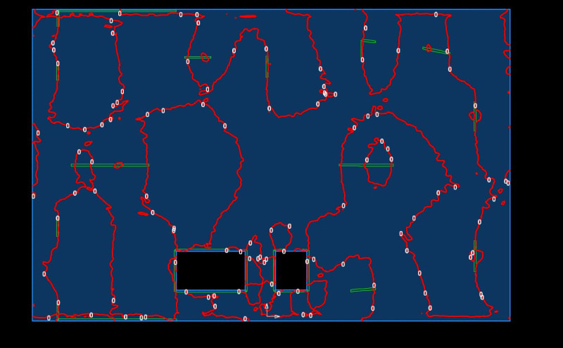

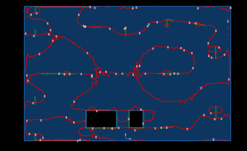

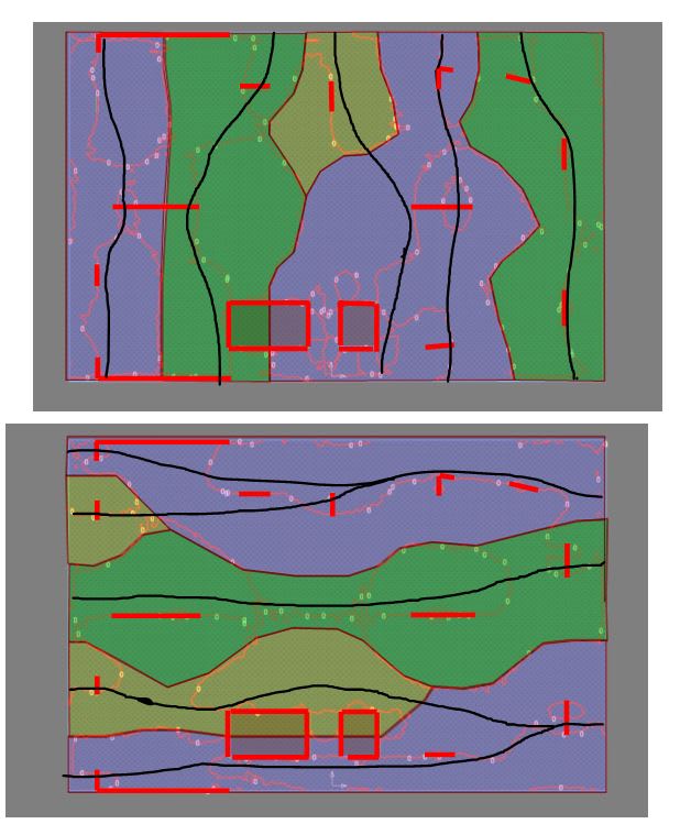

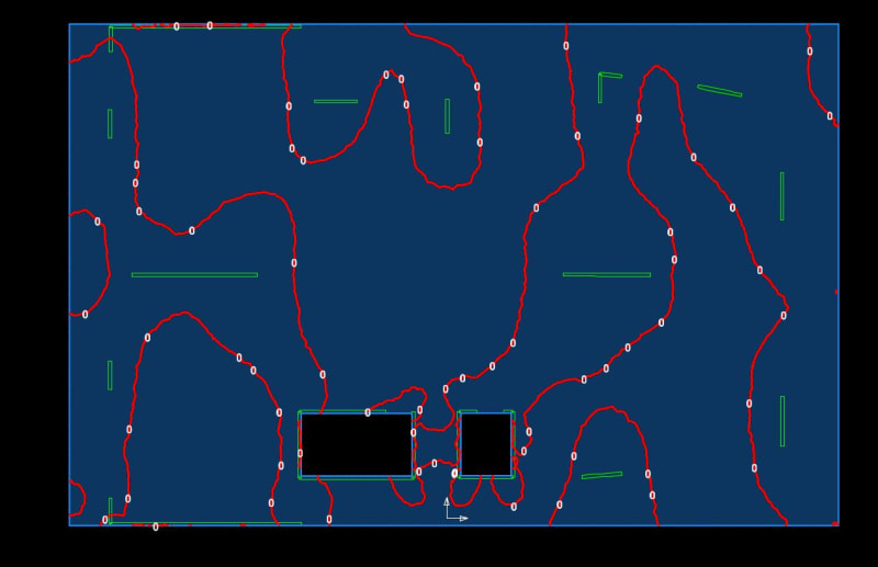

For now, I've just allowed the slab to tell us its story of complexity and shame without passing any superfluous judgment on orthogonality, conductibility, or sweep. Some zero shear lines have been taken as natural bands of stiffness; others as natural points of demarcation between strips which include both the the column strip and half of a middle strip on each side. Essentially, this is the strip disposition that I would anticipate giving a reasonably accurate estimate of tributary load to the columns if the the two orthogonal strip directions were overlaid.
Thank you. Strip force from Ram Concept looks reasonable. Don't know why SAFE gives different results. So does that mean in Ram Concept you can simply place the span segments in ortho directions with reasonable strip widths despite the layout of supports instead of running from support to support with skew angle (I am not familiar with skew angle concept BTW) although it may be not cost effective?
Thank you very much KootK. I will definitely have a look at '0 shear lines' and come back if I have more doubts!
Yeah you are right. I tried to use this method and find something bit weird, even if I set the averaging width to 5meters it still shows much more reinforcement required at top than I used strip method with smaller widths.

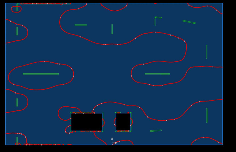

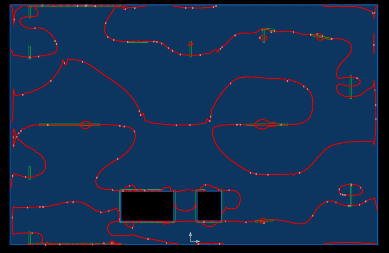

I have an open dialog going with the RAM folks on their enveloping procedure, I'm not certain that design segments with both significant positive and negative moment are being considered in the way that Kootk outlined, based on some section auditing and my understanding of the manual seems its looking at the dominant moment sign only, but I'm not not positive on that so waiting on feedback from them as to what is going on in the backend.
As Rapt noted if you just rely on straight cross section equilibrium you could end up with a net 0 design moment, which while mathematically correct could lead to an unsafe design. Think this is a larger issue for PT in the US market since we have convinced ourselves that full width design strips are adequate but column layouts are becoming much more irregular leading to sign overlaps in strips with significant areas of sign change. For mild slabs this can be avoided or limited by adjusting column and middle strip bounds utilizing the 0 moment plots.
CSI has decent tech support as well reach out to them and see what they have to say about design strip boundaries covering areas of positive and negative moment.
