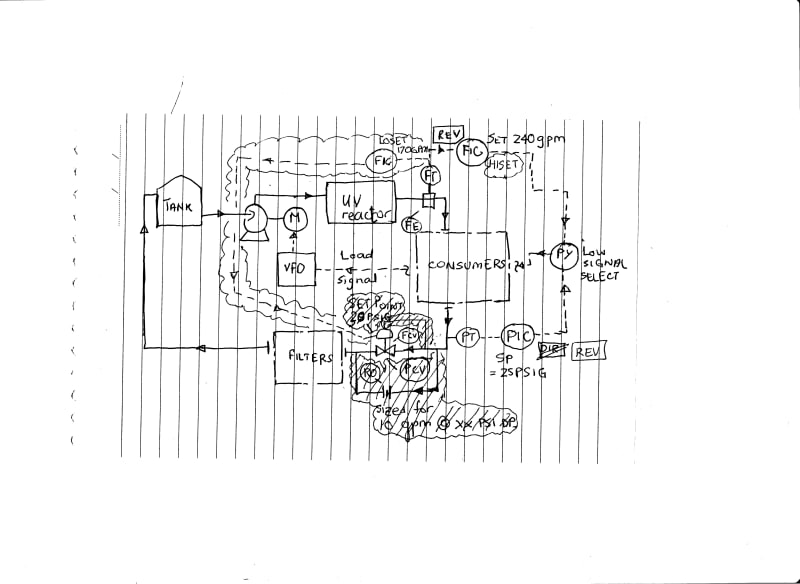

Forgot the bit about the 170gpm min flow requirement. Given the feedback you've got so far from Flomatics and Fisher, here is a revised scheme that will keep this min flow of 170gpm through the tank and filters and UV reactor. Deleted bits from previous scheme are shown shaded out.
Backpressure PCV replaced with a regular control valve to act as min flow control valve (sizing case flow 170gpm with pressure upstream of 30psig, some 10psig(?) downstream, with valve at 70-80% open). No need for CDX10 either. Both hiset and lo set FICs' run off signal from the same FE/ FT. By the way, presume you have some kind of flow restriction device at each consumer to prevent overdraw on supply / supply pressure collapse - perhaps a Flomatics CDX device may do on each user.
PS :Error in my sketch/ narrative here : Since you dont want a dead leg at the filters and return line either when flow through UV reactor is more than 170gpm, keep that CDX10 on the bypass around the FCV.

I'm going with George's design because it makes complete sense. It's similar to what I started with but with all the missing blanks filled in.
I thank you very much for your help and drawing. To limit tank fill rate I had been relying on pipe sizing, but using a CDX device on those is a good idea and makes the loop more predictable to operate. I'm going to integrate these changes into my drawings and get going on building this system out. [thanks2]

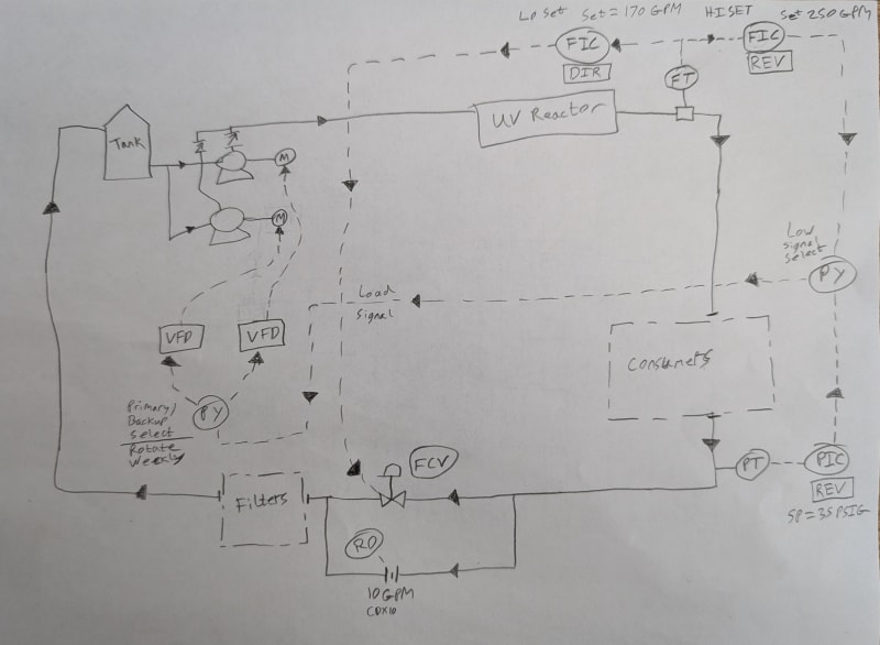

I went ahead and re-drew the diagram to make sure I understood it and to incorporate errata, as well as adding the dual pump setup. Hopefully this seems correct:
Okay. You can run with this now.
Some minor "grammatical" improvements:
a) the weekly switchover selector is usually marked as HS - hand signal for local manipulation
b) the CDX 10 on FCV bypass is not a regular restriction orifice, and I dont know what the symbol and label for this is - maybe someone reading this with more instrumentation knowledge on ISA symbology can help
c) the signal going to the FCV is usually shown going to the actuator of the valve, not the body of the valve. BTW, what type of control valve will you be going for here ? @ LI suggested an all electric stepper motor actuated one, if that turns out to be cheaper than a pneumatic control valve with I/P convertor and feedback positioner ?
a) Noted. I'm going to try and make that automatic.
b) Noted.
c) That makes sense, I didn't even think about that. I'm going with an electrically actuated v-ball with position feedback because that's my area of comfort. I'm sure the pneumatic stuff would work great, I just don't want to run air all the way over to this area.
Looking good.
I'm not sure though about what signal you're sending to the FCV before the filters?
In an earlier post you said basically that you have 240 GPM from the UV filters, but then consumers of up to 200 GPM. So this would only leave ~ 40 gpm to go through the filters.
Maybe your PT set at 35 psi will then kick in to restrict the flow through the filters for the time period you're filling?
Otherwise if you try to maintain 170 gpm at all times through the filters you will starve the consumers.
Probably needs an operating and control description to go with this.
But definitely a lot better than the initial design.
My understanding and interpretation of how it works is as follows:
The backpressure valve closes as flow rate increases above 170 GPM, eventually shutting off completely to prevent starving consumers. When the flow rate is at or under 170 GPM, the backpressure valve is wide open.
The VFD increases the pump speed when the flow rate drops below 240 GPM, or the pressure signal drops below 35 PSI. The low signal selector chooses the lesser of the two values.

@Hax, I see some anomalies in your controls narrative:
General comments:
a)"The VFD increases the pump speed when the flow rate drops below 240 GPM, or the pressure signal drops below 35 PSI."
It should read as " The VFD decreases pump speed when flow rises beyond 240gpm, or when the pressure signal rises beyond 35psi"
b) The FCV is no longer a backpressure valve, it is a min flow control valve. Backpressure control is now maintained by the PIC set at 35psig
c) The loset FIC set at 170gpm, which now operates an all electric stepper motor actuated control valve, ought to be a REV acting controller - pls revise, unless you see some reason why this FIC should be a direct controller.
d) Since both FICs' are now REV acting, for the sake of these critical control narratives, maybe better to assign tag nos to each.
e)Scenario 1:
e1) " The flow rate will exceed 170 GPM, causing the backpressure valve to start to close from the FIC (DIR) signal".
Should read as: "If the flowrate exceeds 170gpm, ....
f) Scenario 2: Assuming "idle" loop flow means zero flow,
f1)When loop flow is transiently zero, the CDX10 will allow only 10gpm to flow through. The loset 170gpm FIC then will act to open the FIC to maintain loop flow at 170gpm. Loop PIC output will rise and act on VFD to raise pump speed to reach setpoint pressure. At this time, the hiset 240gpm FIC output is at saturation (ie 100% output), so the PY will select and forward the PIC output to pump VFD
g)Scenario 3:
g1) Since consumer demand is only 120gpm, the 240gpm reverse acting FIC will remain at 100% output (total flow is 120+10=130gpm) - the low select PY will not select this FIC output in this scenario - pls revise this entire scenario 3 narrative. The pump will run only on the loop PIC output, which will initially rise, and then stabilise.
h)Scenario 4:
Apply general section corrections only. Otherwise, description is correct.
