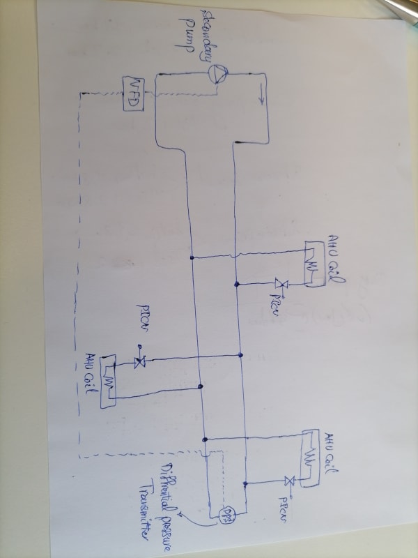

Hi dear experts
Could you please let me know how to get right diffrential pressure value in secondary loop of chilled water system supplying different terminal units?
A diffrential pressure transmitter has been installed in farthest unit and all units are equipped with pressure independent valves. a Vfd is controlling the secondary pump speed according to the pressure value.
i need to determine right pressure setpoint.
Your reply will be highly appreciated.

Can you please sketch this out so we know what location you're looking at.
what options do you have to estiamte the flow for the valves? Pressure is hard, since the PICV typically give you the same flow from 5-50psi (look at specs!). So that doesn't tell you much. that's the whole point, they give you the flow INDEPENDENT of pressure as long as they have the minimum pressure. The problem is, they also work perfectly fine with too much pressure, which cost you pump power.
Can you measure flow over the coil by measuring coil differential pressure or dT? You have to look at the coil specs and it also depends on airflow. So this is not easy or straight forward. Can you measure pressure drop over the PICV (and no strainer or anything else)? You kind of have to find the pump pressure needed to just barely have enough flow... the problem is to find out if you have enough flow.
So my first advice is to find out what options you have to estimate what flow you have. the PICV i know don't have a port to measure flow. they have ports to measure pressure drop, but that isn't related to flow like a balancing valve. You could try to set the system pressure so that all PICV still have 5psi (or what the manufacturer says is the minimum) differential pressure.
Actually I have a project in design and i will talk to the Belimo rep since they had changed their valves since last time I bought them. Maybe look at the PICV specs and talk to manufacturer o learn what they offer.

Dear EnergyProfessional we have some points to measure the picv and coil pressures so please confirm the below method:
1.open all picv valves to get the maximum flow from secondary pump(increase the pump speed until get a right pressure across the picv and coil)
2.Measure the pressure across the picv and the coils that are farthest from the pump
3.if the pressure on the picv and the coil was right(minimum pressure across picv and right pressure across the coil according to nominal flow)
then add picv pressure to coil pressure and set this value as setpoint pressure of the secondary pump vfd drive

If you don't do static pressure reset, it is the same procedure as determining the max pressure. the goal here is to get the max pressure as low as possible while still having enough flow in critical zones.
BTW, adding the reset-function doesn't require added hardware, only programming. That is a huge energy saving. Because the maximum pressure is the pressure you need at full load day, which isn't representative for 364 days of the year.

Here is the thing, if your system has 2-way valves that modulate or are on/off, you have a variable flow system. Flow in all branches will depend on the load in time. So the critical path will change depending on operating conditions. If you had constant volume (i.e. 3-way valves), you would have a critical path that will be the same all the time.
Best you can do, is determine the critical path under the assumption all valves are 100% open. But this will be sub-optimal since that is not how the system operates in real life.
Your system is a constant volume system with SOME variable volume features. But not all variable flow features. so yo still need to control pressure like in a CV system.
I'm not quite sure if you plan to relocated the dP sensor, but that requires pipe work. it is easier to implement static pressure reset since that only is a programming work and is agnostic to where the sensor is located.
Close-off pressure of a PICV is extremely high (50 psi, or so). That is not what you control for. You need the design flow pressure (often 5psi, but check with manufacturer).
Look at the sensor spec. they are rated for the system pressure, often 50 or 100 psi. Measuring a 5psi or less differential pressure will be relatively inaccurate. If you have a % accurate sensor, that is 2psi on a 100 psi sensor. That's why I use them for around the pump where we have more pressure. Some are differential sensors and you pipe from both ends water to the sensor. Some are standalone sensors where you have 2 sensors directly in the pipes. While in theory the "farthest" location may be better, that is only the case with perfect sensors and not with real sensors.
