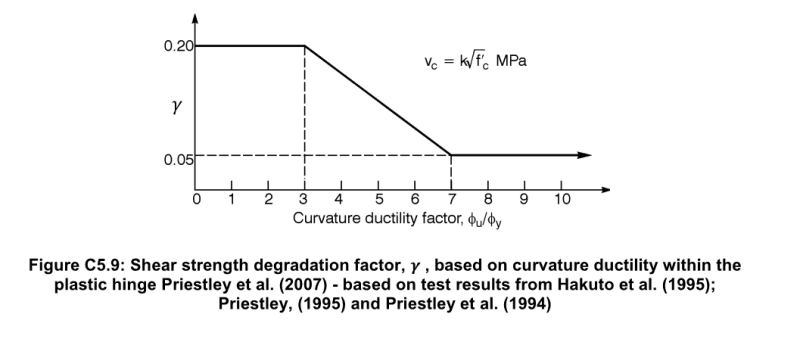

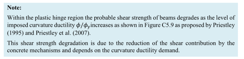

There is a known degradation in shear capacity with increasing curvature, it's not something someone made up for no reason, i.e. something like this:-
This reduction is the outcome of many of the contributing factors noted in discussions above with respect to shear capacity at higher ductility/curvatures in plastic regions.
EDIT- added this as it explains it in words:-
The text they refer to is this one:-
Displacement Based Seismic Design of Structures by M.J.N. Priestley

The graph kind of makes me sceptical, this expression is used for determination of shear strength if failure is due to tension. I think I read one of the articles mentioned in the text and it was tensioned based failure. I attached a picture to show what I mean by tension or compression failure.
I seem to mention this a lot, but tension controlled failure means nothing because in design you consider Vc = 0. You don't however consider Vc,max = 0 (or VRd,max or Vu,max). You can't influence Vmax by adding any type of reinforcement, just by changing the thickness of a wall.
Since those are different mechanisms, their degradation shouldn't be the same. For example, due to dynamic nature the cracks smooth so mechanical interlock becomes weaker. While that may be important for tension controlled failure it doesn't make any difference when talking about compression controlled failure.
I'm sorry if I don't make much sense, I don't know, maybe I think there is something that doesn't exist.
I think you are possibly confusing concrete cracks (principle tension issue at crack location) with zero or limiting shear strength occurring due to crack forming. To be honest I'm having a few issues following your argument, however I'll point out again that its been explained a few times that this isn't the primary mechanism related to shear strength in concrete, its aggregate interlock in relatively simple terms, the bits between the cracks can still carry load more dependably. You keep coming back to the tension argument on a macro level being a driver to explain the behaviour, but it seems flawed to me (at least) as its one part of a number of complex concrete mechanisms that are no doubt going on.
You posted a number of failure mechanisms related to shear, most standards design rules probably cover these mechanisms. They just aren't exposed to the user. Our code has specific rules for preventing sliding shear (which only governs at very high shear demand). All this does is make sure you have more shear reinforcing, the contribution from the concrete is still the same. But one function of the addition of the reinforcement ensures also that you can develop this concrete component in a dependable manner.
A member could be cracked to hell and still have shear strength. That curve I posted is a result of many mechanisms, I don't think you can boil it down to a single factor which you might be searching for?

The curve I posted isn't a function of the many types of individual failure limit states being reached, its a function of what mechanisms are going on inside the concrete at a given yield curvature ratio such as degree of cracking, degree of concrete crushing, degree of aggregate interlock, degree of reinforcement elongation, other factors you've noted, etc as it affects the shear capacity derived from the concrete contribution. These mechanism applies equally to the concrete shear capacity (your first equation for Vrd,c above). The 'material' mechanisms I referred to are these, not the individual ultimate mechanisms of failure to clear up your point about not being the SAME MECHANISMS.
They are different modes of failure, and they may well have different rates of decay, but the same 'stuff' is going on inside the concrete up until any one of these failure mechanisms is reached if you like and I guess that the codes take the most conservative value in developing the degradation curve, a lower bound value that may not recognise the actual capacity if a given configuration happened to fail in another manner. Does it always reflect reality, maybe not, but does it make the economy of design easier for the poor designer not having to evaluate 6 different failure states by knowing that you only need to evaluate the most critical code approach, hell yes. In a cyclic hinge, concrete is getting hammered in reversing compression/tension/shear, so arguably at that point a universal reduction is palatable because all those mechanisms are occuring in the same bit of concrete in a full cycle.
Have you plotted out those degradation curves from the paper so you can share the differences? I guess in terms of what you design for only if they crossed and one was more critical at certain levels of load than the other would it be of any practical use.

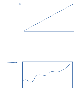

It's so obvious. We even talked about it in this thread. There's a picture of a guy who wrote the code saying "we didn't put it in because it would limit the usage of this system". That's the proof that it would have influence.
All I tried to say by "different mechanisms" is the following. Consider the picture
both of these can fail either by one triangle sliding on the other along a line or curve.
Another failure can occur by crushing of the diagonal.
Now, both of these will crush at the same force, but won't slide at the same force. That's all I meant, that some things that are important for one type of failure aren't important for other type. So if you say that reduction of sliding capacity occurs because the bottom pic became top pic, crushing won't care because it's independent of the roughness of the crack. So one of them can decrease without the other one decreasing.
