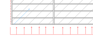

Does anyone have a resource of a design example for a roof with diagonal decking installed at a 45°? CSA O86 doesn't provide much of anything aside from some commentary on it, and the only diagram they give is for a shearwall.
O86 instructs me to design the boundary members (chords) for the out of plane component, but since the decking members don't have shear transfer between adjacent members I can't quite figure out my load path to determine the loads on these members. O86 gives an equation, but it appears that it is assuming that the chords are one continuous member from one shear collector to the next, whereas I have edge purlins that start and stop. That is to say, the bending moment diagram of the decking would be based on the overall length between collectors, but each individual edge purlin is 1/4 of that length since I have 4 bays.
Similar to the above, I can't see how without shear transfer between the planks, that load in the N-S direction actually makes it out to the shearwalls on the left and right for the option 1 framing. If I draw the UDL and try to follow the load path, it almost seems that the left wall never has any load dragged into it. Is the assumption that the load goes axially into the plank, then at purlin intermediate supports it jumps over and makes it way out?
My shearwall orientation is 2 endwalls and a central wall, so a large H shape essentially, but for wind in the direction parallel to the single central shearwall the load path doesn't appear to actually make it to the center unless I change the decking orientation at some point to start collecting it into the middle.
I've attached a crude sketch of the framing, intended shearwalls are currently shown red. The north and south walls are full of openings and can't be relied on as shearwalls (I haven't drawn the openings). Planks are drawn for orientation only, not drawn to scale.

Edit: I've read the section you mention, and it is pretty similar to what O86 says. I just don't quite understand how the load goes from the windward/leeward faces out to the shear collectors without the 2x6's being fastened to eachother somehow. Like if you take a vector as shown, how does the load ever make it out, especially for planks crossing multiple bays.

I've designed many repairs and additions to diagonal sheathed roofs. I use the allowables from the SDPWS as I practice in California and design it like any other flexible diaphragm. You will need to provide a typical detail showing how the joints are staggered, ie. the adjacent diagonal boards joint does not line up with the boards next to it.
Mostly friction. Tested assemblies were about twice as stiff as real roofs that dried/shrunk in service, so the calculated deflections (in the tables) account for the additional flexibility. Some nail slip is also anticipated, so even planks that have shrunk away from each other eventually mobilize enough friction through deformation and nail slip.
Each deck board to joist connection has at least two fasteners. Those function as a bunch of little, highly questionable moment connections. So it's kind of like a Vierendeel truss of sorts.
With respect to the calculation of boundary element forces, this changes nothing relative to a conventional diaphragm. The mechanism of shear resistance is just different. And worse obviously.
It's not as though deck boards are the only funky diaphragms out there. Corrugated steel deck does a pretty nifty, in plane, torsional mambo under shear strain.
Functionally, it's not much different from an unblocked plywood sheathed diaphragm. It's not as if all those sheets of plywood are attached together either, APA recommends a 1/8" gap between sheets.

So the diaphragm moment is still calculated as we normally do, and we get the chord forces by dividing by depth as normal, the only change is that the chords get designed for an our of plate element as well as axial.

4.2.8.3 of 2021 SDPWS2021 says:
"Each chord shall be considered as a beam with uniform
load per foot equal to 50% of the unit shear due to dia-
phragm action. The load shall be assumed as acting nor-
mal to the chord in the plane of the diaphragm in either
direction."
The O86 commentary reads:
"Loading on single-layer shearwalls and diaphragms creates additional forces that need to be addressed in design. These forces occur in the boundary members parallel to the interior framing members (i.e. studs in shearwalls or joists in diaphragms). The normal load component, acting perpendicular to the boundary member, creates a moment, Mf, that must be accounted for in the design of the boundary member."
I think this is due to the fact that the planks are installed on 45° angles, so it creates an Fy and Fx component in the decking that needs to get resolved at each end. With typical sheathing I'd wager you are much more rigid such that there isn't really bending of the individual chords.
