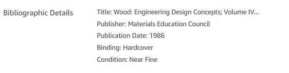

The Diekmann article can be found in this book:
Diekmann also authored the diaphragm chapter in the 1989 wood handbook:

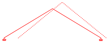

I agree with post #39, if the boundary conditions shown below were present, both diaphragms would engage. I don't understand the jump to post #43:
a) The presence of vertical restraint at the pitch breaks is often necessary for diaphragm load distribution
Wouldn't two rollers & no restraint @ ridge still engage both diaphragms from lateral displacement? Meaning sky hooked be damned, as long as the diaphragms are pinned, they're both engaging.
No, I don't think so.
I started my diatribe with this simple assertion: what matters for load sharing is that both diaphragms experience compatible, in plane displacement under lateral load.
Are you in agreement with that? Because, if you are, the answer to your question is right there in your sketch where you have shown the windward diaphragm moving much more in plane than the leeward diaphragm. And I love that because it means that, on an intuitive level, you feel this.
Of course, everything is a matter of degree. If the leeward diaphragm experiences some amount of movement, it will pick up some amount of load. But I would argue that could me much less load than we normally assume when we do conventional diaphragm design.
