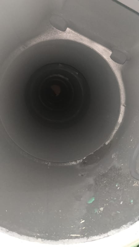

In the pictures you provided there is a duct from the turbocharger that makes a 90 degree turn and then enters the intercooler. If you could remove that elbow you would be able to view the intercooler and inspect it for clogging.
No you don't have to drain engine coolant tomopen ducts and inspect the intercooler.
Edit: looking more closely, it appears the duct is part of the compressor housing so removal of the entire turbocharger would be required.

Looked at the pictures again after Tug's comment, looks like there is a spool piece between the compressor housing and the inlet of the aftercooler. So it looks like just the end bells of the aftercooler can be removed and the core inspected. I'd likely just drop the inlet spool pieces and see if they show signs of oil.

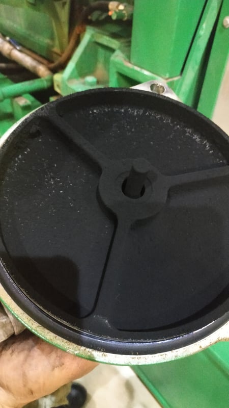

Also, on the picture showing the inlet manifold on the left bank, there is a small pipe attached to the turbo compressor outlet elbow, what does that pipe connect too?
You also mentioned a crankcase fumes disposal system, with part of it attached to the exhaust, can you provide some more details on that? Crankcase fumes disposal system that regurgitate crankcase fumes into the engine, either the intake or exhaust, coupled with extended no or low load runtimes pretty much always lead to problems, at least in my experience.
MikeL.
Ohh, that small pipe is actuation line to valve for coalescer filter outlet. This is a part of crancase ventilation system. I did not find details in manual, but in theory once compressor increase outlet pressure, it must open valve from coalescer filter to exhaust line. Vacuum from exaust should suck air from crankcase through coalescer. Coalescer will stop oil fumes, accumulate it and pass it down through drain line. Near intercooler at right side, you can see small drum, that is coalescer filter.

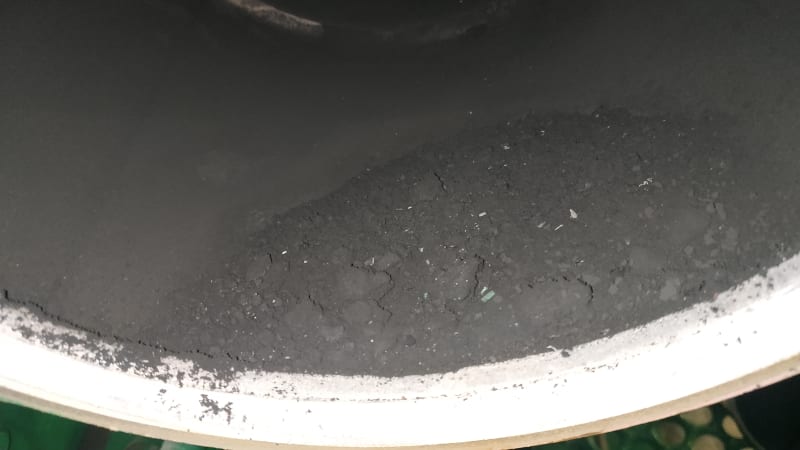

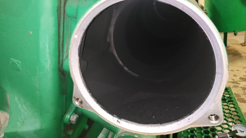

One more finding (or maybe its normal) - when I removed plug from intake air manifold for pressure gauge installation, I have noticed that end of plug is dirty with soot. Today I decide to recheck - open manifold cover and found soot is everywhere inside, and even collected a small hall of soot nearby cover. Same time, using lighting torch, I noticed that output of intercooler looks like clean (no soot on surface). I thought - maybe soot blocked MAP sensor on other side, and remove cover with MAP/MAT sensors as well. It was dirty, but not clogged. we cleaned soot from surfaces and from sensors, and closed covers back.
BTW, we installed pressure gauge on intercooler inlet. And I found plug on exhaust output, once I find 100mBar gauge, I'll install it there.
So question to experienced mechanical staff: is that soot OK inside intake manifold?
Viktor
Electrical Technician II
Without knowing full history of your engine and its operation, I'd say that looks excessive, inlet systems are supposed to be clean, chunks of soot and carbon material can migrate to the cylinders and cause issues. And all that material has to come from somewhere.
On the aftercooler, looking at the outlet side is not a very good indicator of what is condition is, even just looking at the inlet side doesn't always give you a good idea, most plugging occurs within the core as the compressor outlet air starts to cool. Taking off each end bell and looking thru the core with a strong light is probably the best solution.
