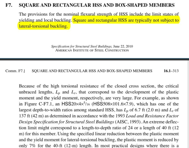

LTB could control design in tall and skinny rectangular HSS beams..there's a check for it in the flexure section of the steel manual. Obviously not a concern for square and relatively square rectangular sections.
Fair enough, there may be a tall and skinny enough member to have LTB issues, I will not rule it out, but section F7 of AISC steel manual does not even address the failure mode in the spec. the commentary notes it is not typically and issue (see attached)
As far as "rules of thumbs" go, I would say it is not likely an issue (but should be checked in a final design)
There actually is a section under F7 in the 15th edition, F7.4. But fair enough, I ran a few calcs on a HSS10x2x1/4..and for typical spans the effect is fairly limited...only an 8% reduction in Mn for a 20ft unbraced length. Deflection probably makes it a moot point in most cases. Still worth being aware of.
One difficulty with the AISC checks is that I believe that they implicitly assume in plane support restraint of each of the four walls of the HSS. That's often not the case for practical HSS support connection. The result being that overall section warping will reduce LTB capacity more than the AISC equations would suggest.
If rules of thumb are the order of the day, here's one: keep HSS h/b ratios in the 1.5 - 2.0 range.
