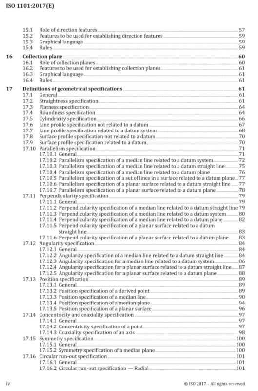

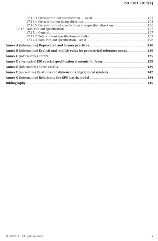

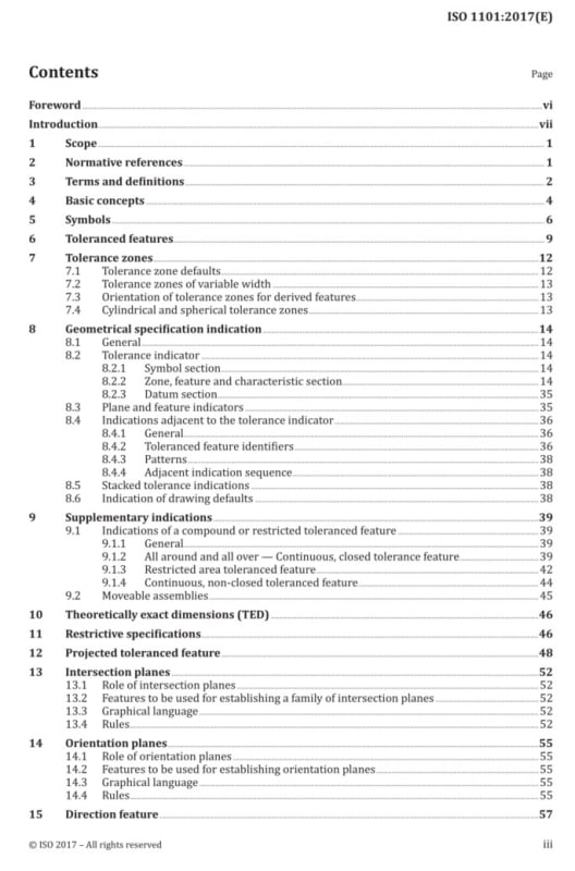

Are there any differences at all between the content of ISO GPS standards and the corresponding DIN English language standards?
Examples,
ISO 1101:2017 Vs. DIN EN ISO 1101:2017.
ISO 12780-1/2:2011 Vs. DIN EN ISO 12780-1/2:2011.
DIN is the German version (German national standard) based on the ISO International Organization of Standardization.
Some national standards MIGHT have a slight alteration of the released ISO originals.

ISO 12780-1:2011 Geometrical product specifications (GPS) — Straightness, Part 1: Vocabulary and parameters of straightness
ISO 1101:2017 Geometrical product specifications (GPS) — Geometrical tolerancing — Tolerances of form, orientation, location and run-out

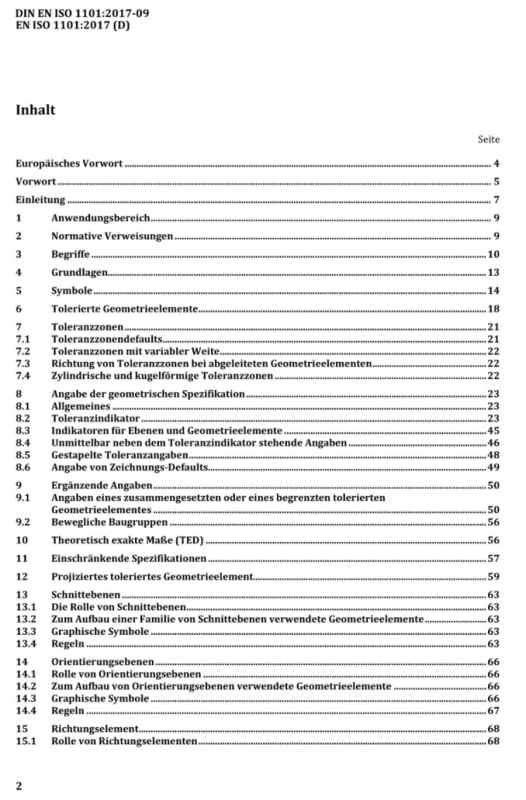

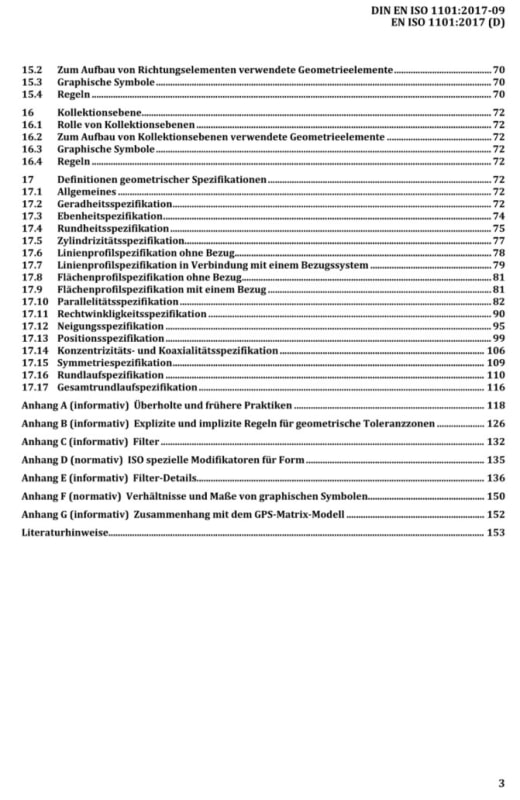

DIN and ISO should be aligned. HOWEVER, I have found one example where the German edition of a DIN standard was unique, where the English version of that same DIN standard matched the ISO standard of the same number. For some reason, the German language version had a whole extra section that wasn't in the ISO version (any language) or the same DIN standard in English. What I learned? It might be a good idea to double-check the German version when calling out a DIN.
I think its almost the same on the contents of 1101 standard
Exactly. Its good to understand the designation of standards, whether it be for GD&T, piping or machinery, ATEX, or whatever.
As an example, I have EN-EN-ISO 80079-36. This is a standard that originates from ISO. It has been adopted by EN (so became EN ISO ....), and was later on adopted by NEN, usually by means of translation.
NEN and DIN are in principle the same type of entities/institutions: one is for the Dutch (NEN) the other for the German (DIN). The English have BS, the French have NFN, etc. Sometimes, by national adoption, slight alterations can occur, but it's usually for translation purposes.
