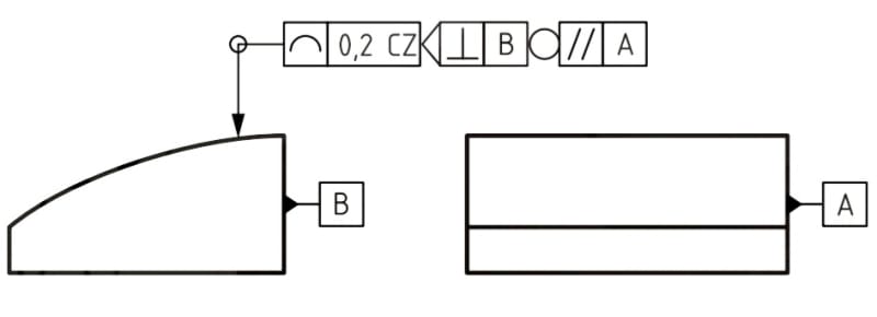

ISO GPS system:
Can UF and collection plane be applied together?
(UF above the tolerance indicator and collection plane as a supplemental indicator)
I don't have access to all ISO GPS standards, but in the ones I have I cannot find an applicable example where UF and Collection plane are used together.
Is it feasible? Is it legal? Any good examples?
Thank you so much and have a great day/ weekend
greenimi,
Besides CZ and SIM, there is also CZR (combined zone rotation). All three group individual tolerance zones into a pattern of tolerance zones.
There is also UF which groups multiple features into a single feature.
And there is CT (common tolerance) which may be used in conjuction with a directly toleranced dimension to specify that a collection of features of size "shall be considered as one feature of size.
Regarding your second question, the standards say that these modifiers may be specified but don't have to be when all non-redundant DOFs are constrained. So I think it's a matter of preference and there are pros and cons of both options. I would definitely not recommend mixing the usage of both options within one drawing, though.

While waiting for an expert to chime in, let's try to interpret based on what's written in the srandard.
The definition is:
"3.6
collection plane
plane, established from a feature on the workpiece, defining a closed compound continuous feature.
Note 1 to entry: The collection plane is always used when the “all around” symbol is applied."
Further, there is:
"16.1 Role of collection planes
Collection planes shall be used when the “all around” symbol is applied. The collection plane identifies a family of parallel planes, which identifies the features covered by the “all around” indication."
And:
"16.4 Rules
A collection plane shall be indicated when the “all around” symbol is used to identify that a specification applies to a collection of features. A collection plane identifies a set of single features whose intersection with any plane parallel to the collection plane is a line or a point."
So, does that "collection" include the inclined back face and the hole from your scenario? What is your opinion based on the above texts?
