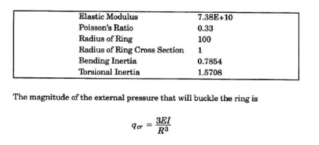

Another example which can be illustrated (which has been discussed at length on this forum) is this:
Link
Let us take a test case as shown below:
(Note: All values given above are in SI)
Per Roarks the buckling pressure is given as:
qcr = 3*E*I/R^3 = 1.74E+05 N/m
Doing a linear buckling analysis in MSC.Nastran:
qcr = 1.71E+05 N/m
So the results match theory to ~2%
Doing a linear buckling analysis in Inventor Nastran:
qcr = 2.09E+05 N/m
The results are off theory by ~20%
It looks like Inventor Nastran would require the user to do a full fledged geometric non-linear analysis to compute the buckling load. This would include the follower force effects. But doing this for a linear problem just because the linear buckling solution fails to include the follower force terms sounds to me like a huge over-kill!!
